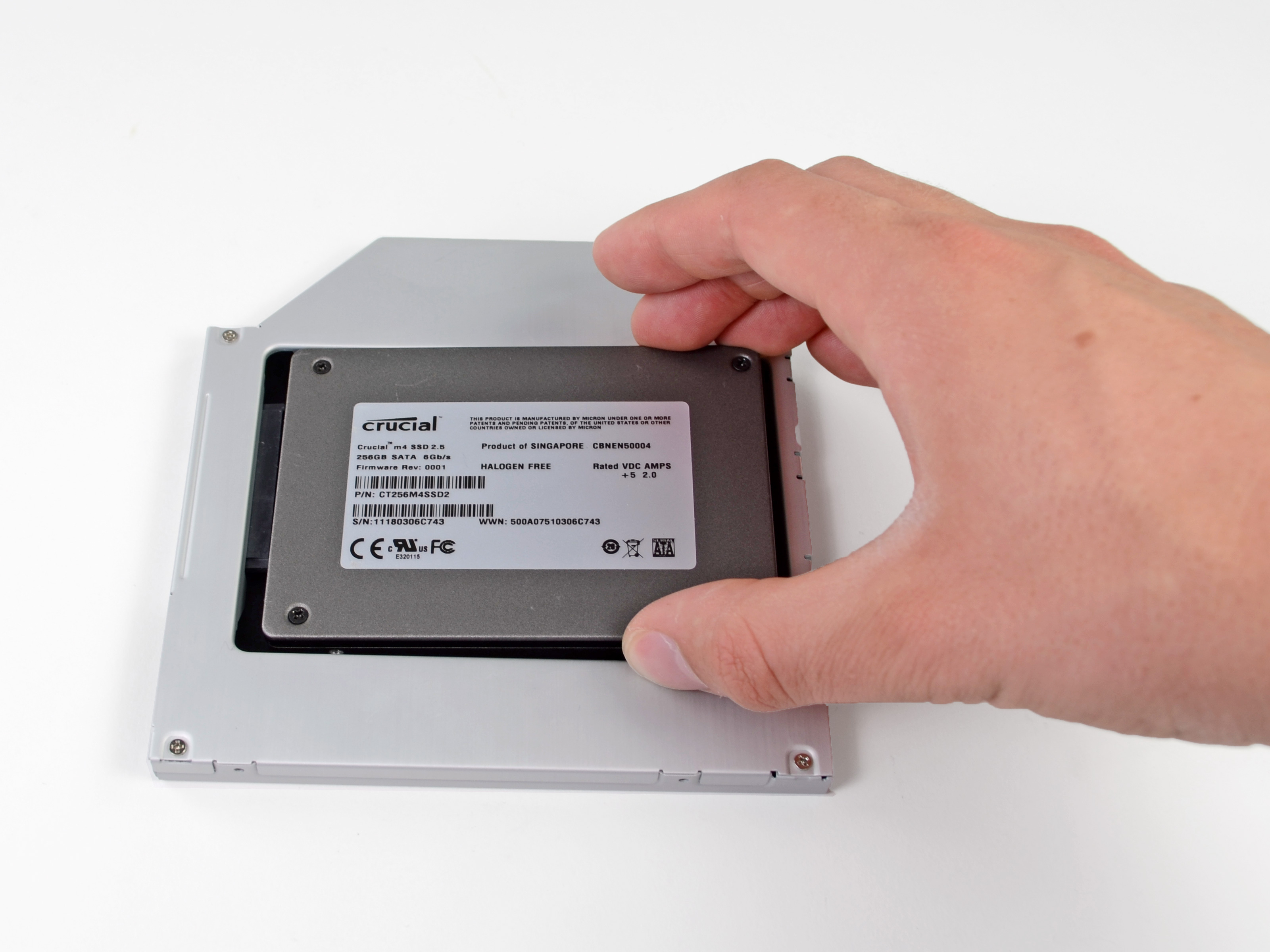

  16. Installing MacBook Pro 15" Core 2 Duo Models A1226 and A1260 Dual Hard Drive: step 16, image 1 of 3 Installing MacBook Pro 15" Core 2 Duo Models A1226 and A1260 Dual Hard Drive: step 16, image 2 of 3 Installing MacBook Pro 15" Core 2 Duo Models A1226 and A1260 Dual Hard Drive: step 16, image 3 of 3
    • Make sure that the hard drive connectors are facing down before placing it into the enclosure.
    • Gently place the hard drive into the enclosure's hard drive slot.

iFixit sells a SATA to ATAPI cage for the hard drive. You'll get slightly slower speeds than via a SATA connection, so if you're thinking of installing an SSD I would move the spinning hard disk to the cage. The photos shown in the guide after step 16 are incorrect, as they reference the SATA optical drive included on newer MacBook Pro models.
