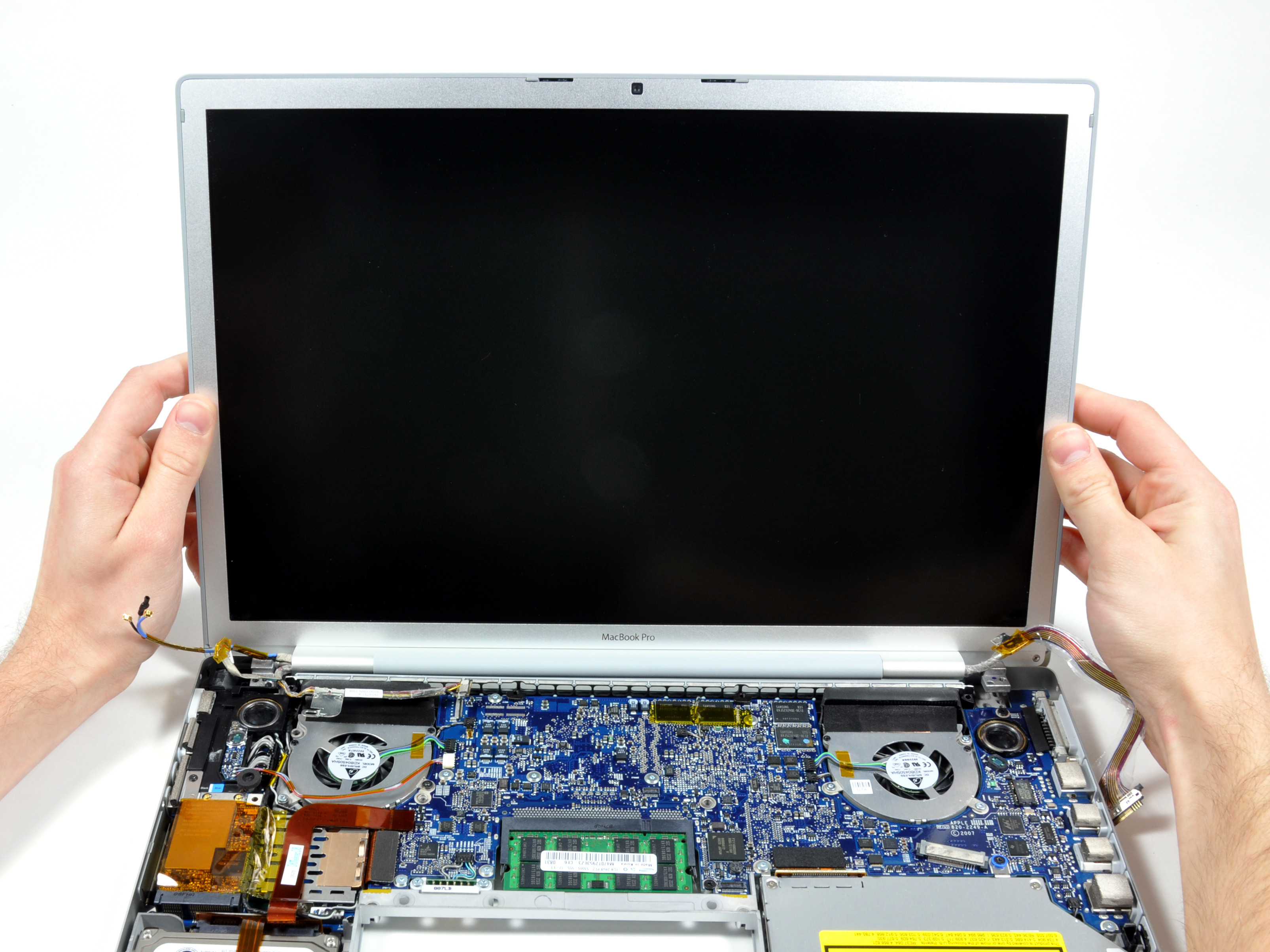

  10. MacBook Pro 15" Core 2 Duo Models A1226 and A1260 Display Assembly Replacement, Display Assembly: step 10, image 1 of 1
    • Disconnect the two or three antenna cables attached to the Airport Extreme card. Depending on your model, one of the three cables may be unused and capped with a black shrink tube.
    • Apple was kind enough to include a label showing where each color antenna cable plugs in - just make sure to look at this when reconnecting the antenna cables.
  11. MacBook Pro 15" Core 2 Duo Models A1226 and A1260 Display Assembly Replacement: step 11, image 1 of 1
    • Deroute the Airport antenna cables from their channel in the left speaker.
  12. MacBook Pro 15" Core 2 Duo Models A1226 and A1260 Display Assembly Replacement: step 12, image 1 of 1
    • Disconnect the iSight cable from the logic board by sliding the cable to the left and out of its connector.
  13. MacBook Pro 15" Core 2 Duo Models A1226 and A1260 Display Assembly Replacement: step 13, image 1 of 1
    • Support the display with one hand while removing the following screws:
    • One 9.5 mm silver T6 Torx screw with threads on only 3 mm of the shaft on the inside of the display hinges.
    • One 9.5 mm silver T6 Torx screw with threads on the entire shaft on the outside of the left hinge.
    • One 9.2 mm full thread T6 Torx screw securing the iSight cable ground loop to the fan.
  14. MacBook Pro 15" Core 2 Duo Models A1226 and A1260 Display Assembly Replacement: step 14, image 1 of 1
    • Disconnect the inverter cable from the left I/O board by placing a spudger beneath the cable and lifting up.
  15. MacBook Pro 15" Core 2 Duo Models A1226 and A1260 Display Assembly Replacement: step 15, image 1 of 2 MacBook Pro 15" Core 2 Duo Models A1226 and A1260 Display Assembly Replacement: step 15, image 2 of 2
    • Disconnect the display data cable from the logic board.
    • Remove the foam bumper from the top of the right hinge of the display.
  16. MacBook Pro 15" Core 2 Duo Models A1226 and A1260 Display Assembly Replacement: step 16, image 1 of 1
    • Remove the silver 9.2 mm T6 Torx securing the ground loop in the display data cable to the casing.
  17. MacBook Pro 15" Core 2 Duo Models A1226 and A1260 Display Assembly Replacement: step 17, image 1 of 1
    • Support the display with one hand while removing the following screw:
  18. MacBook Pro 15" Core 2 Duo Models A1226 and A1260 Display Assembly Replacement: step 18, image 1 of 1
    • Grasp the display assembly on both sides and lift it up and out of the computer.
