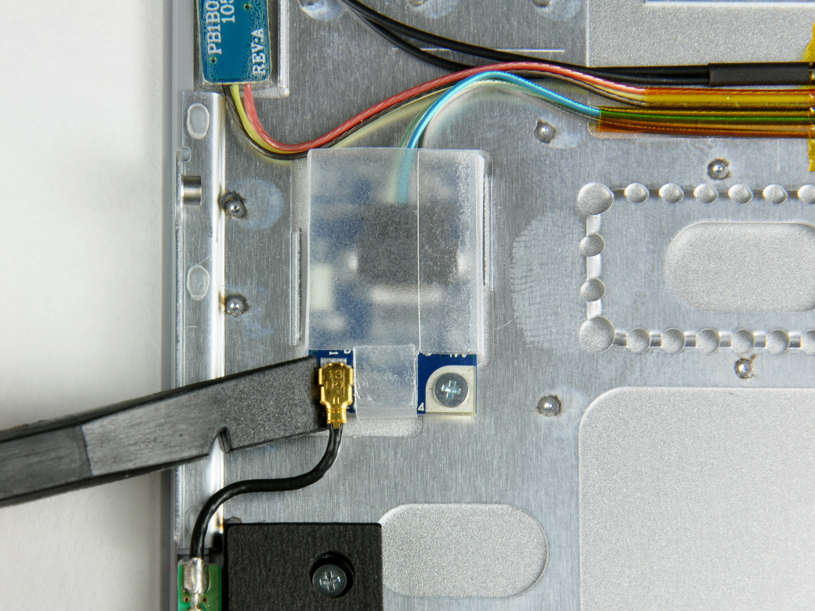

Add Note Edit Step 10 — Bluetooth Board  ¶
  • The Bluetooth board is located underneath the upper case.
  • Disconnect the Bluetooth antenna cable from the Bluetooth board.
first image
Add Note Edit Step 11  ¶
  • Remove the single Phillips screw securing the Bluetooth board to the upper case.
first image
Add Note Edit Step 12  ¶
  • Peel up the Bluetooth data cable from the adhesive on the upper case, removing tape as necessary.
first image
Add Note Edit Step 13  ¶
  • Disconnect the Bluetooth data cable from the upper case.
  • Lift the Bluetooth board and attached cable off the upper case.
