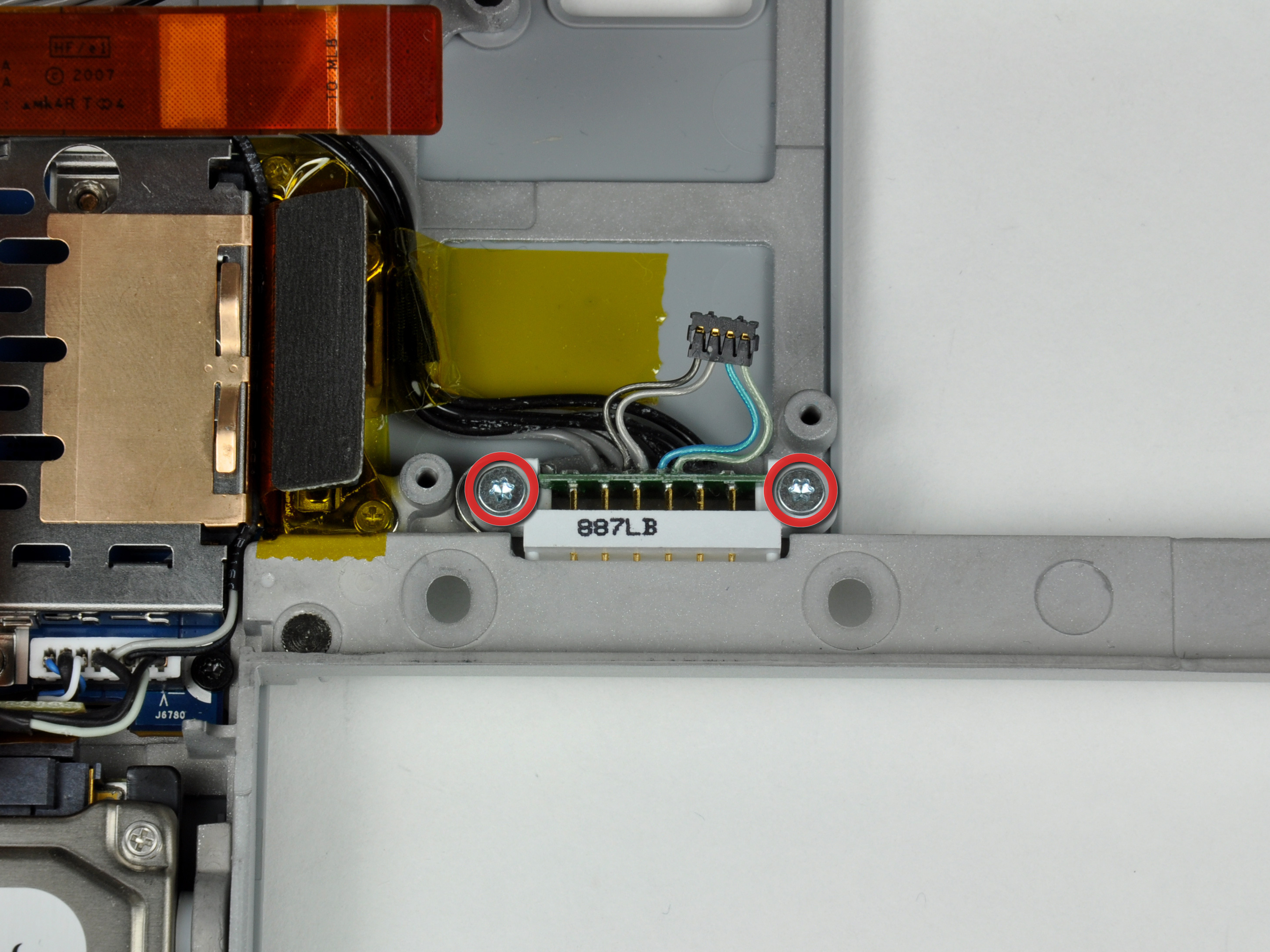

Add Note Edit Step 22 — Battery Connector  ¶
  • Remove the two silver T6 Torx screws securing the battery connector to the lower case.
first image
Add Note Edit Step 23  ¶
  • Disconnect the large gray and black battery connector cable from the left I/O board.
first image
Add Note Edit Step 24  ¶
  • Thread the gray and black power cable beneath the speaker cable, and lift the battery connector out of the computer.
