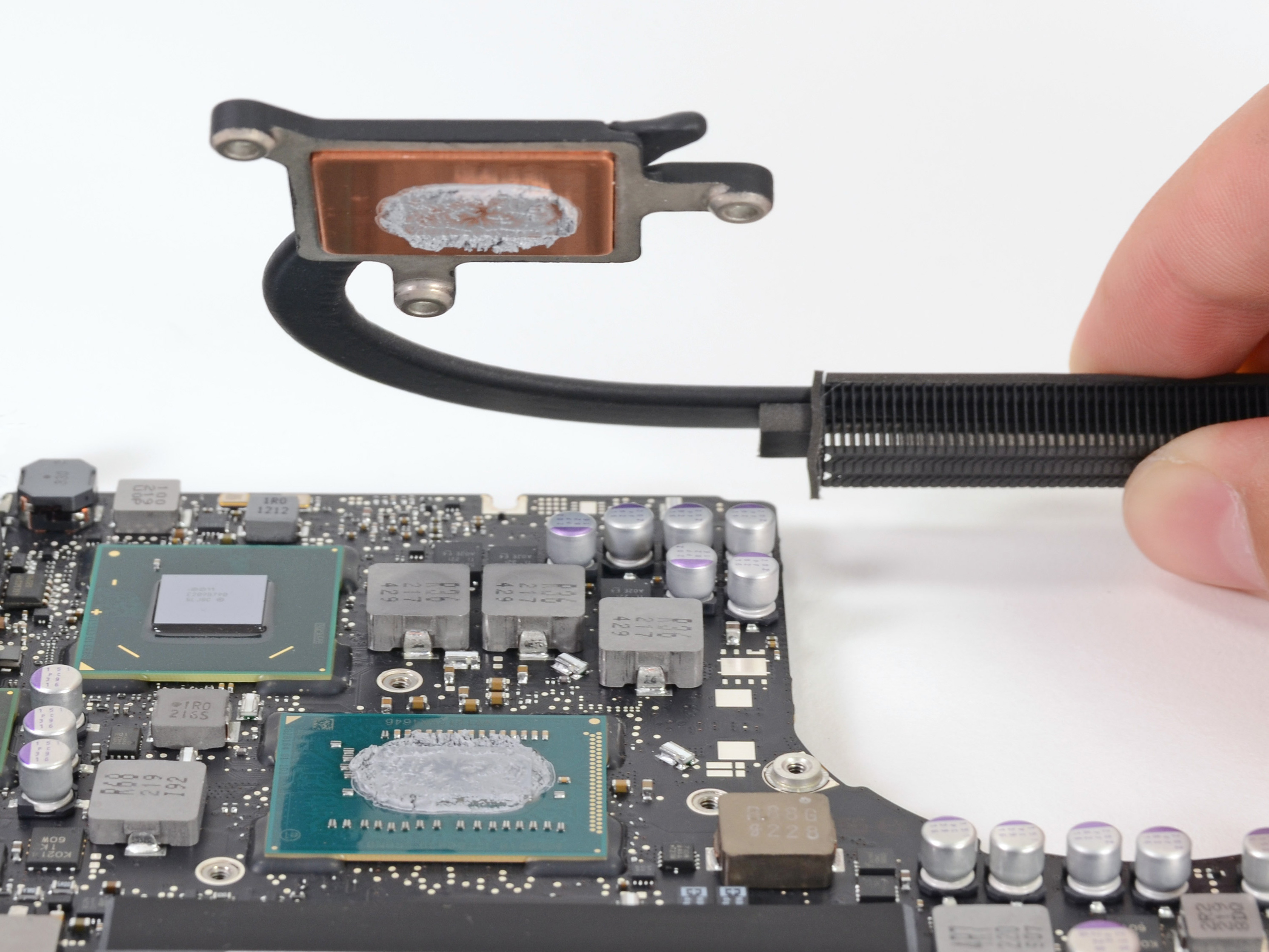

Add Note Edit Step 8 — Logic Board  ¶
  • Use the tip of a spudger to pull the right speaker/subwoofer cable out from under the retaining finger molded into the upper case.
  • Pull the right speaker/subwoofer cable upward to lift the connector out of its socket on the logic board.
