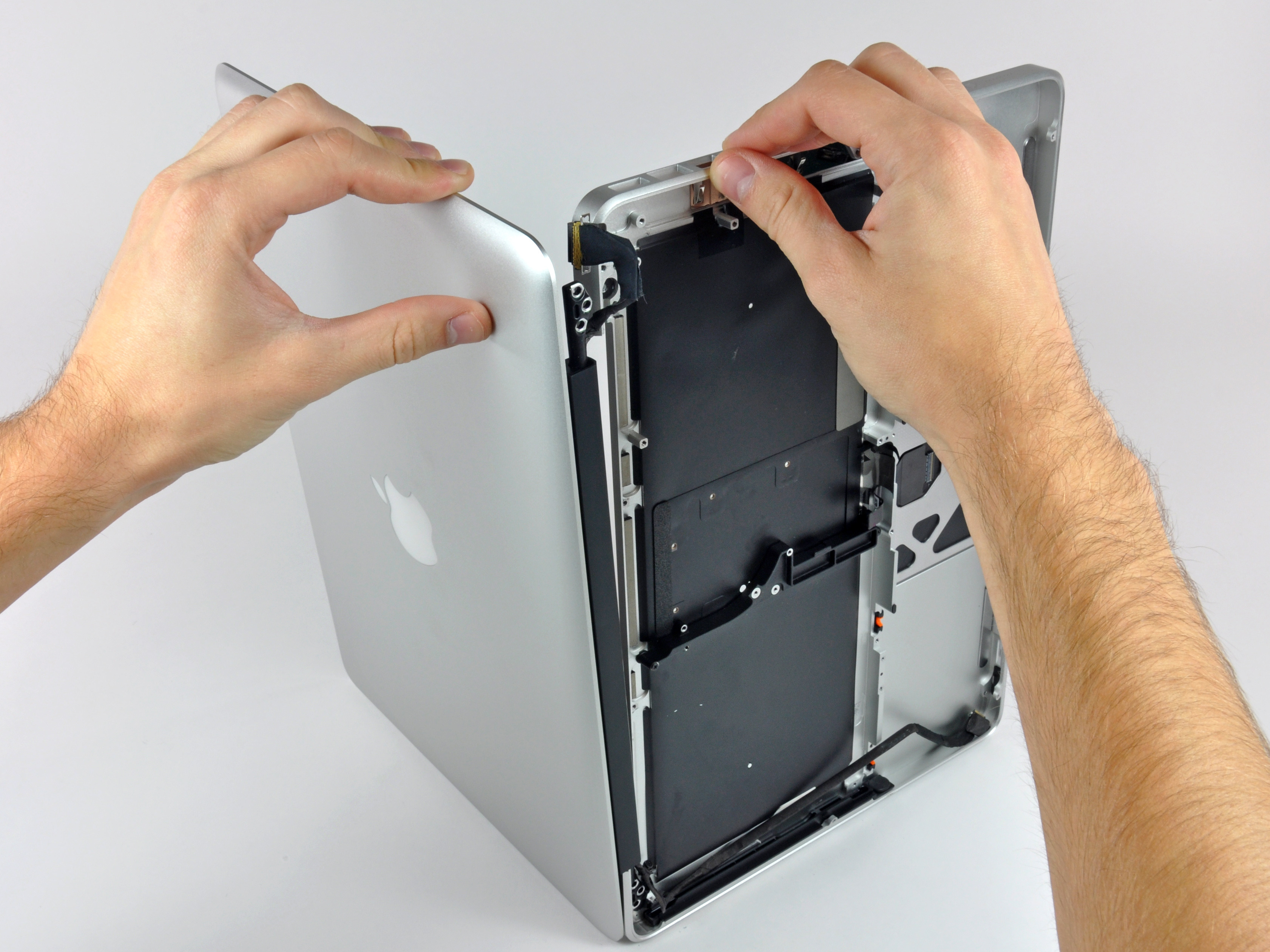

  • Remove the following 10 screws securing the lower case to the MacBook Pro 13" Unibody:
    • Seven 3 mm Phillips screws.
first image
Add Note Edit Step 2  ¶
  • Slightly lift the lower case and push it toward the rear of the computer to free the mounting tabs.
first image
  • For precautionary purposes, we advise that you disconnect the battery connector from the logic board to avoid any electrical discharge. This step is optional and is not required.
  • Use the flat end of a spudger to lift the battery connector up out of its socket on the logic board.
