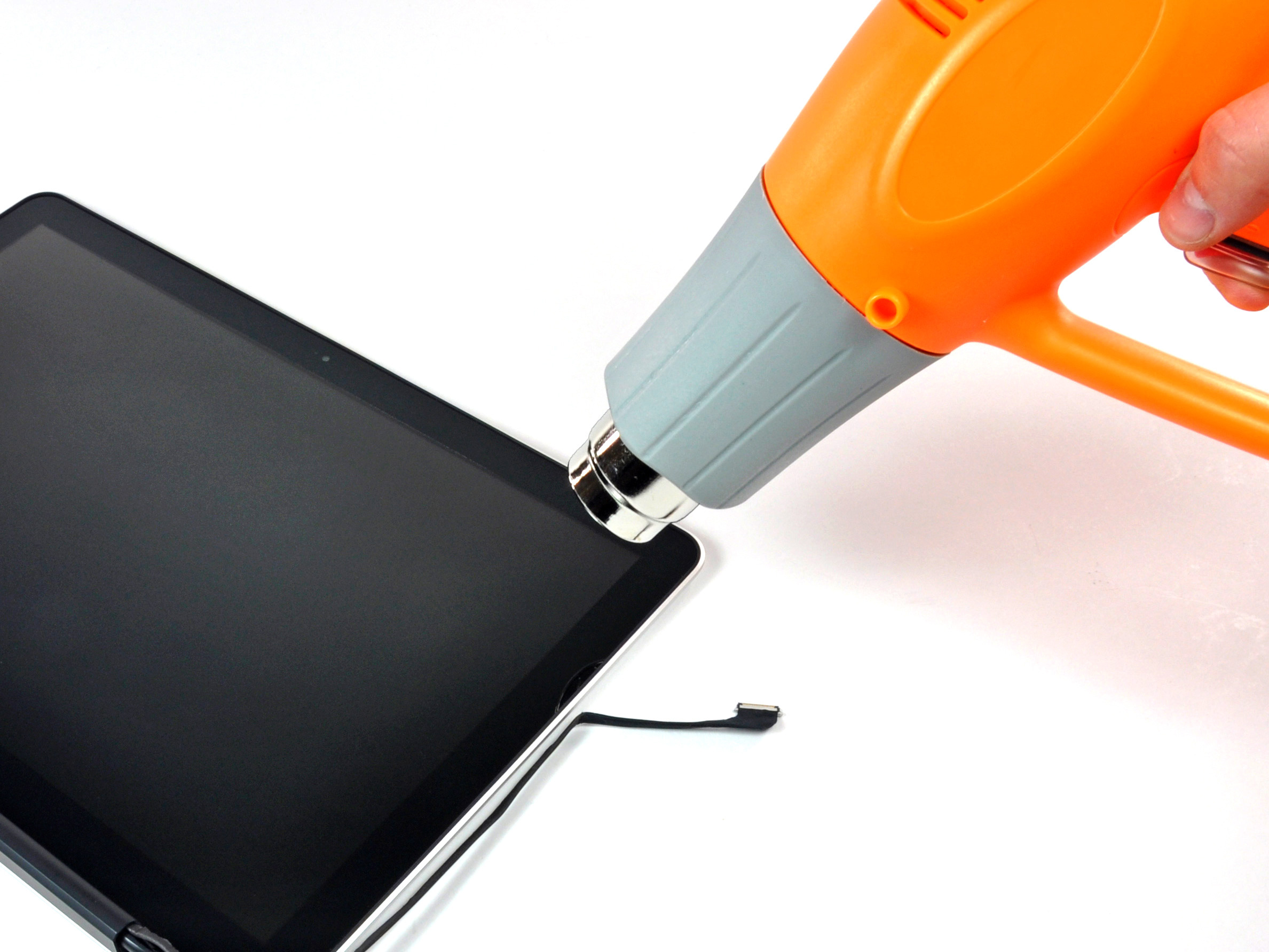

Use this guide to replace a broken front display glass panel. Removal of the front display glass is required to access the LCD.

Add Note Step 8  ¶
  • Grab the plastic pull tab secured to the display data cable lock and rotate it toward the DC-in side of the computer.
  • Pull the display data cable connector straight away from its socket.
  • Make sure to pull the connector straight away and not straight up from its socket.
