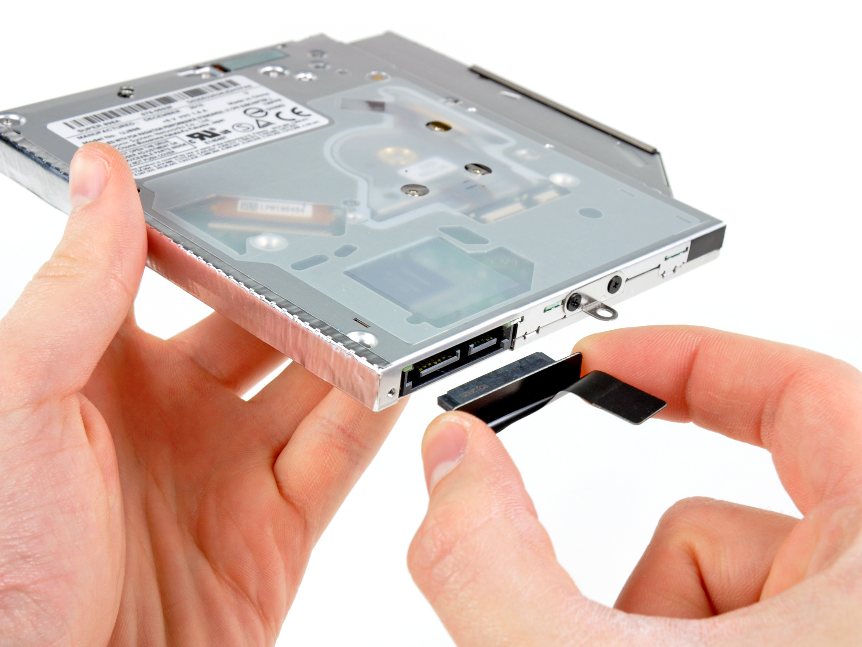

Add Note Edit Step 16 — Optical Drive Replacement  ¶
  • Pull the optical drive cable away from the optical drive.
  • Be sure to pull on the connector, not the cable itself.
  • Optical drive remains.
