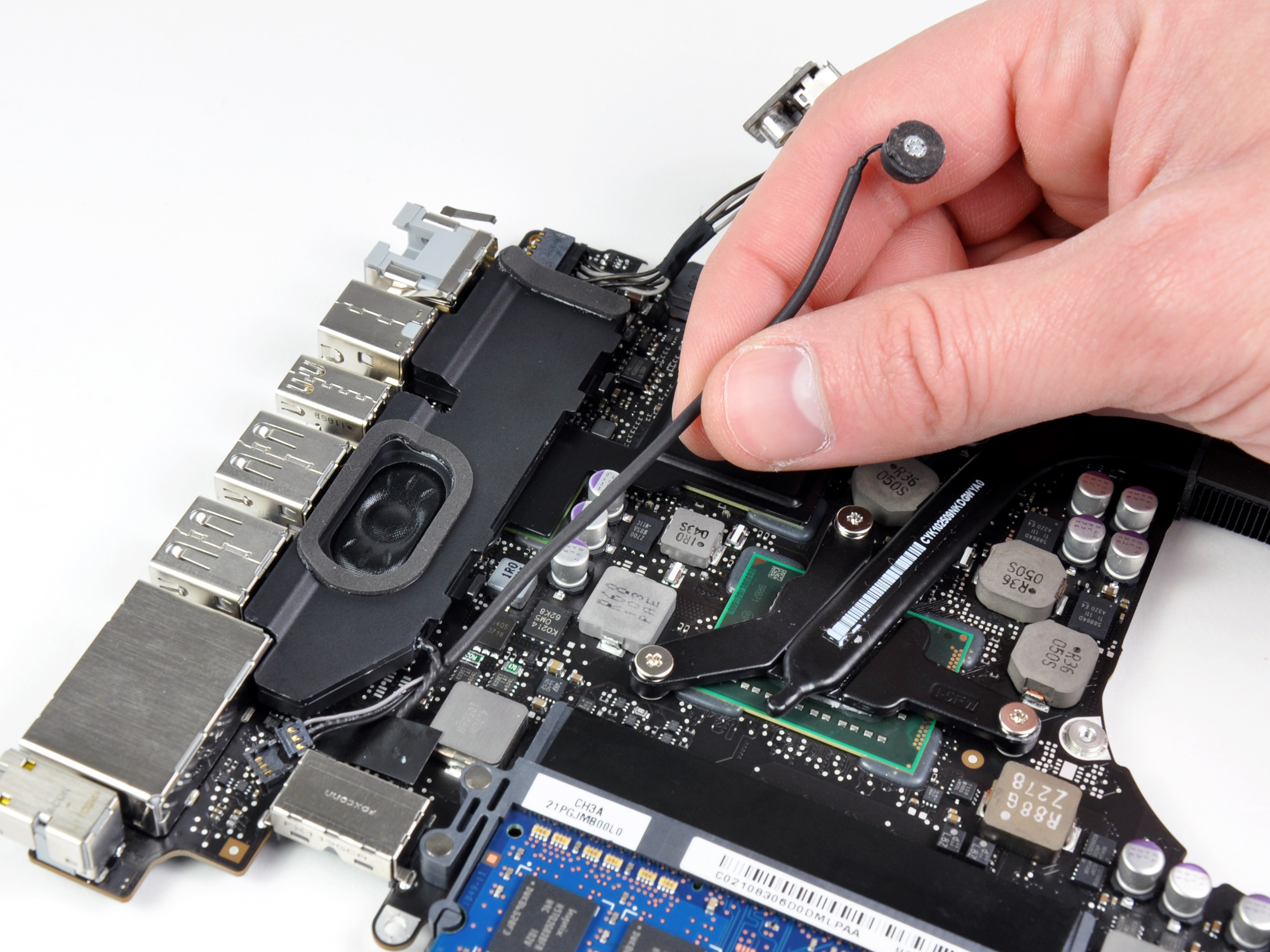

Add Note Edit Step 20 — Microphone  ¶
  • De-route the microphone cable from the channel molded into the left speaker housing.
first image
Add Note Edit Step 21  ¶
  • Remove the small piece of black tape covering the microphone connector.
first image
Add Note Edit Step 22  ¶
  • Use the flat end of a spudger to pry the microphone connector up from its socket on the logic board.
  • Pry up from beneath the wires.
first image
Add Note Edit Step 23  ¶
  • Remove the microphone from the logic board.
