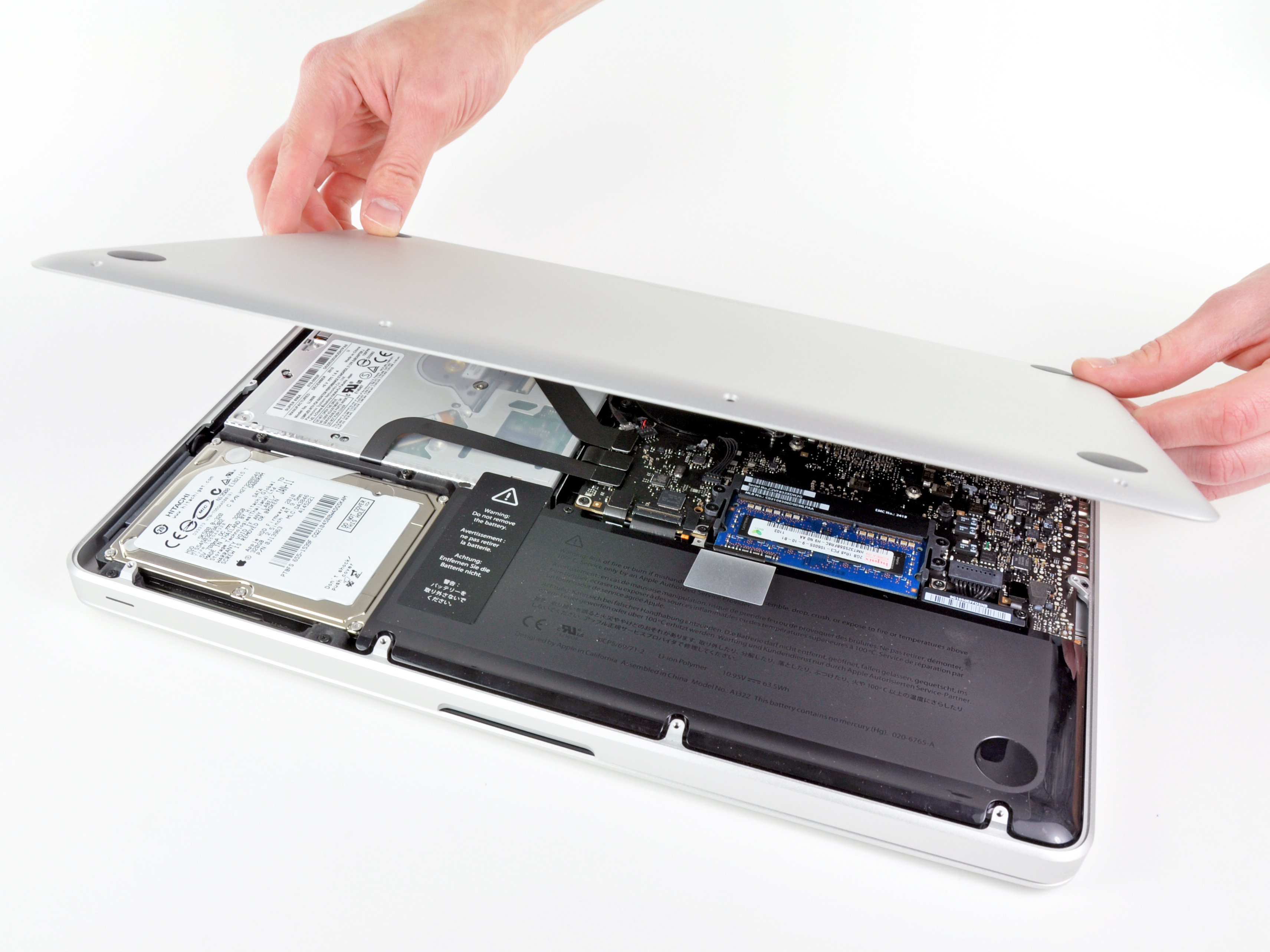

Remove the lower case to access the internal components of your MacBook Pro.
Image #1
  • Remove the following ten screws:
    • Three 14.4 mm Phillips #00 screws
    • Three 3.5 mm Phillips #00 screws
    • Four 3.5 mm shouldered Phillips #00 screws
Image #1 Image #2
Add Note Edit Step 2  ¶
  • Use your fingers to pry the lower case away from the body of the MacBook near the vent.
  • Remove the lower case.
