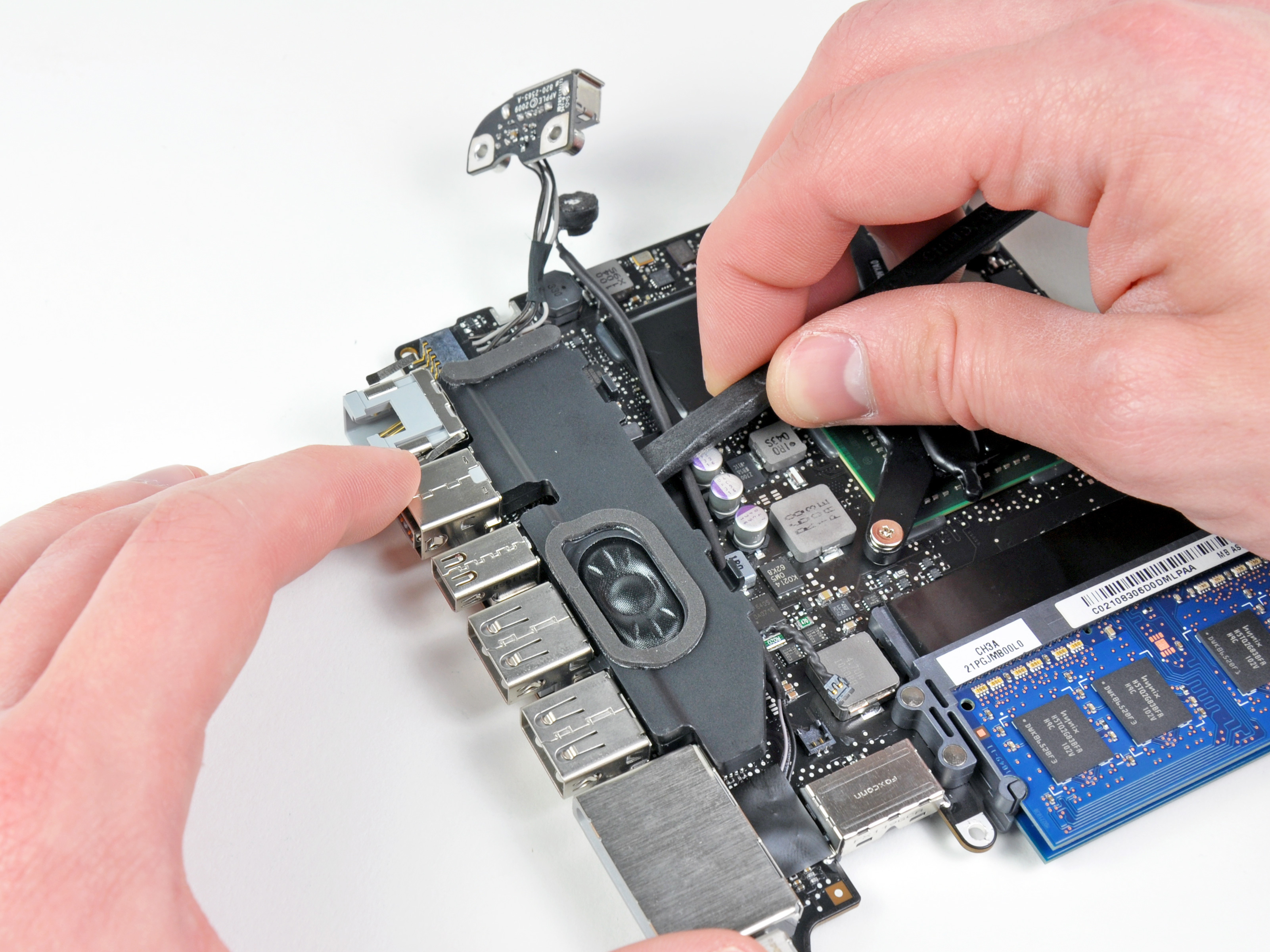

Add Note Edit Step 20 — Left Speaker  ¶
  • De-route the microphone cable from its slot molded into the left speaker enclosure.
Image #1
Add Note Edit Step 21  ¶
  • Remove the small piece of black tape covering the left speaker connector.
Image #1
Add Note Edit Step 22  ¶
  • Use the flat end of a spudger to pry the left speaker connector up from its socket on the logic board.
  • Pry up from beneath the wires.
Image #1
Add Note Edit Step 23  ¶
  • Carefully pry the left speaker off the foam adhesive securing it to the logic board.
  • Remove the left speaker.
