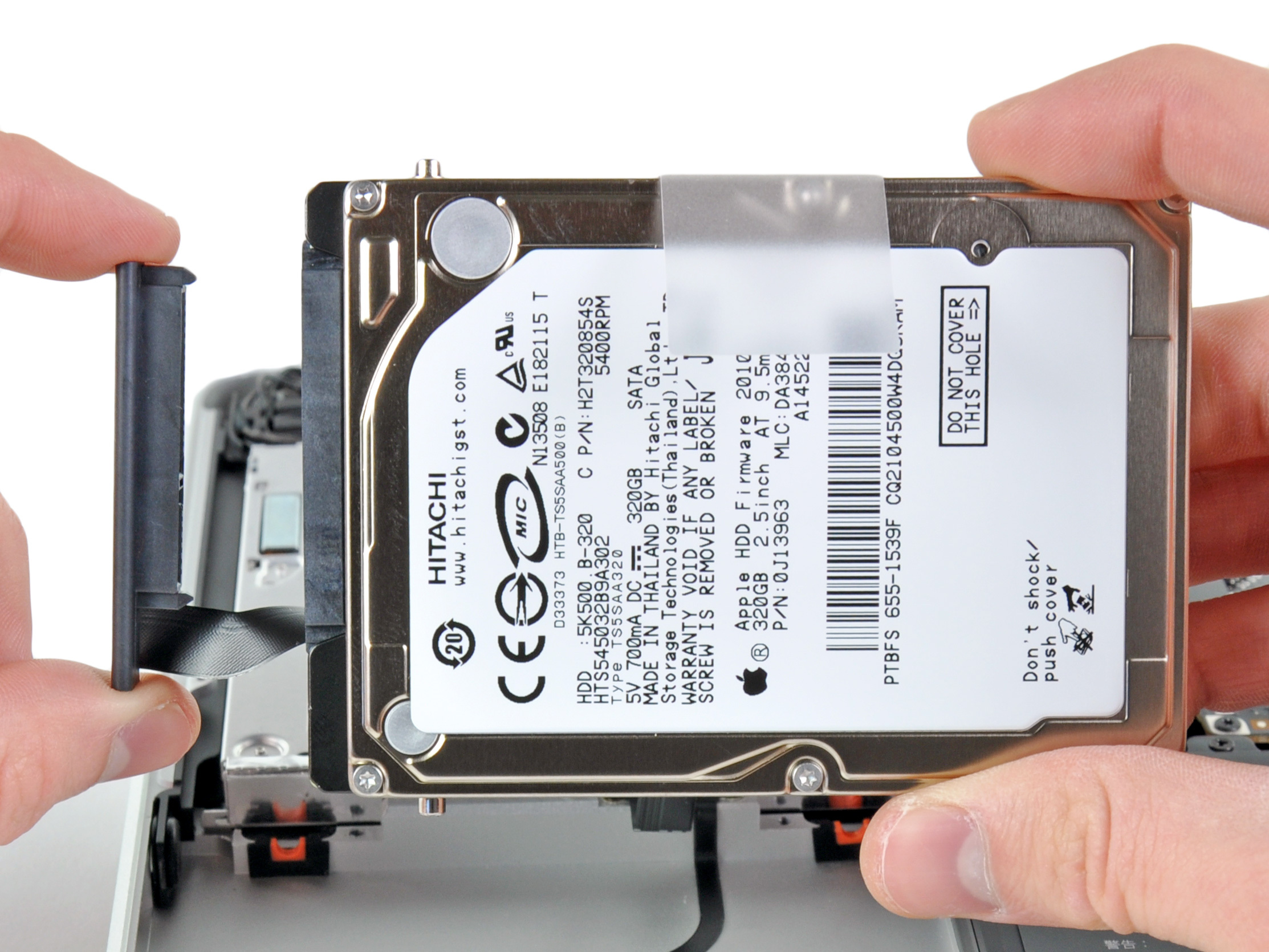

  8. MacBook Pro 13" Unibody Late 2011 Hard Drive Replacement: step 8, image 1 of 2 MacBook Pro 13" Unibody Late 2011 Hard Drive Replacement: step 8, image 2 of 2
    • Pull the hard drive cable away from the body of the hard drive.
    • Remove the hard drive.
