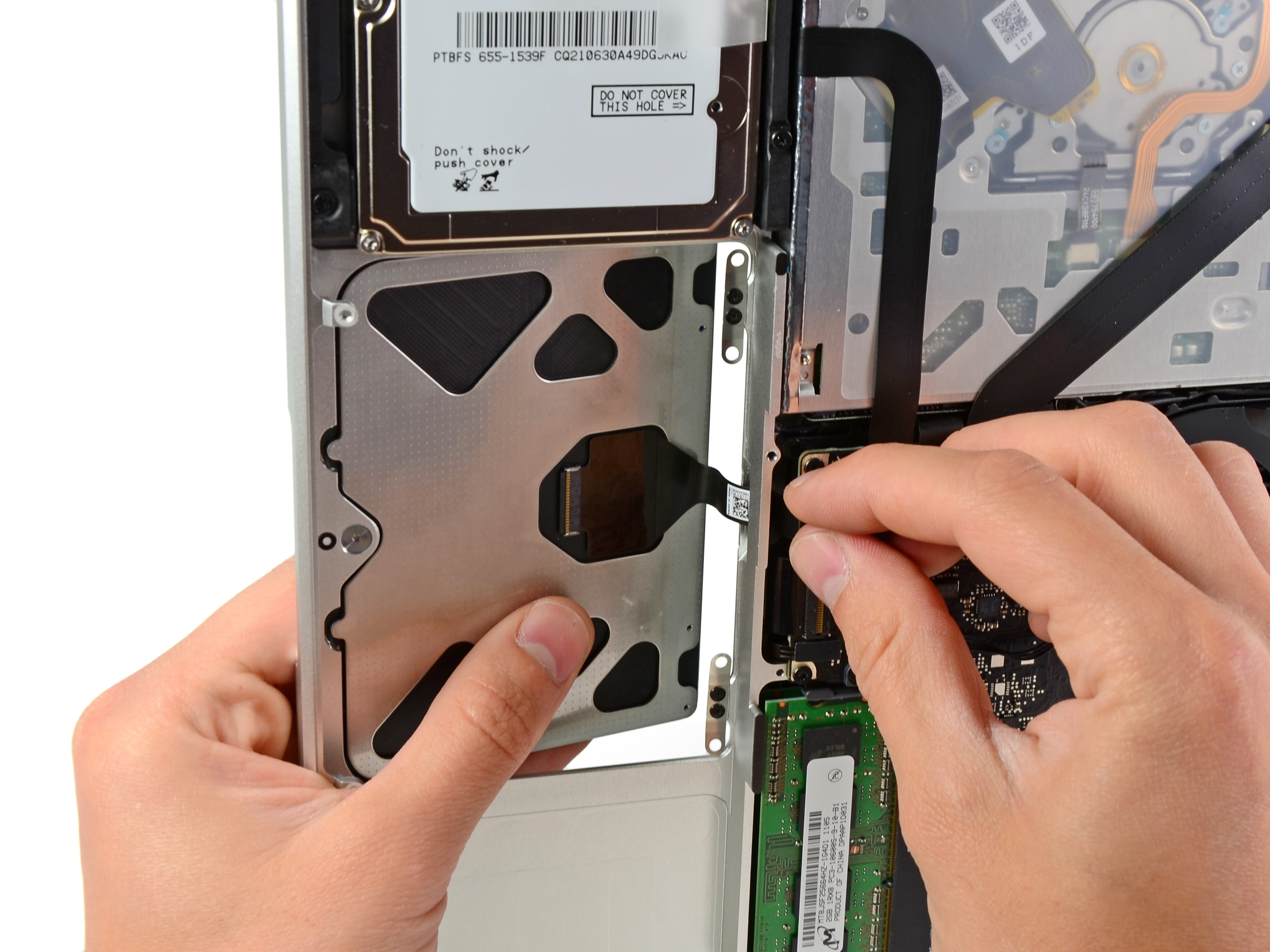

Add Note Edit Step 8 — Trackpad  ¶
  • Use the flat end of a spudger to carefully pry the trackpad connector up from its socket on the logic board.
