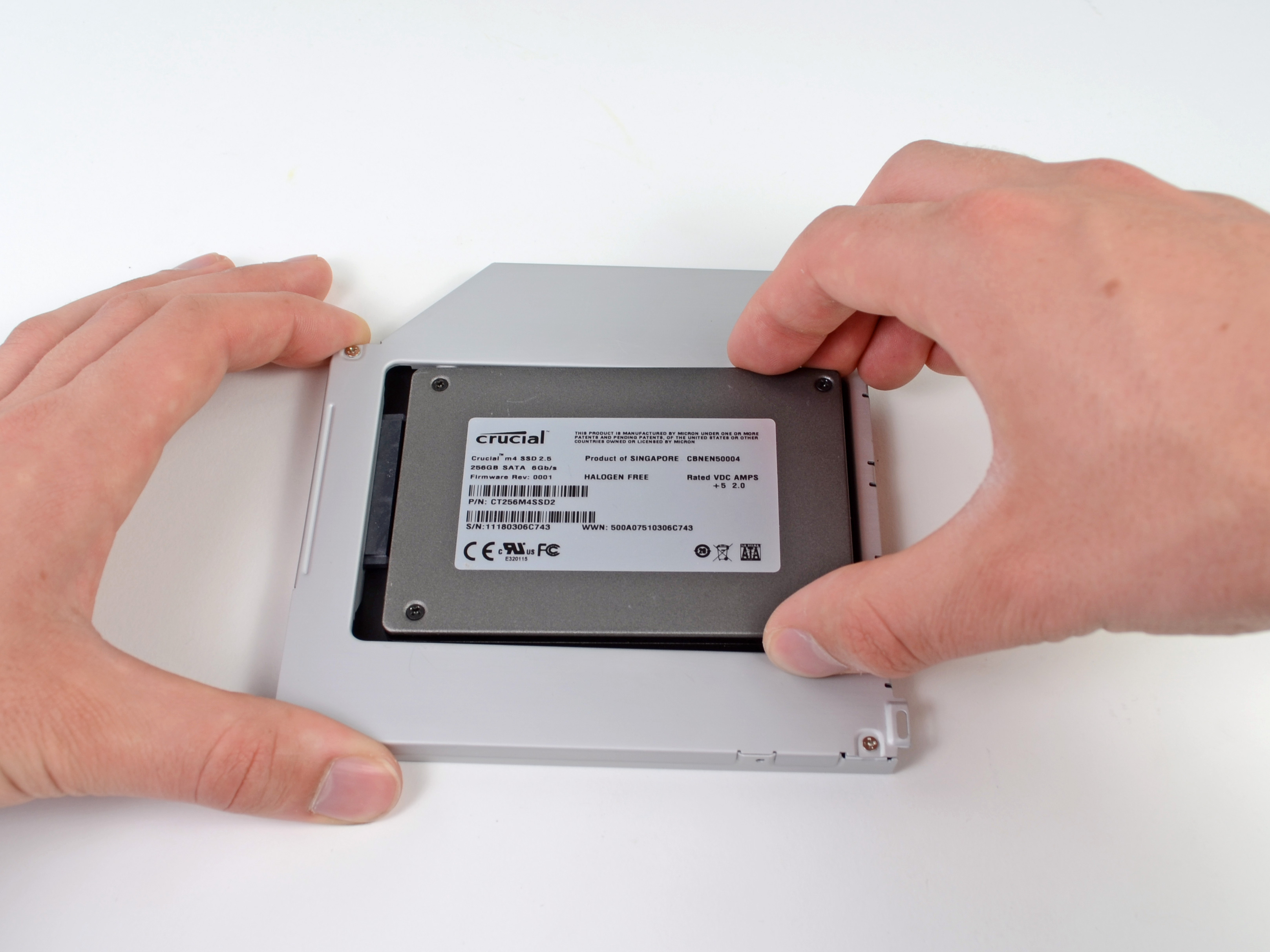

Add Note Edit Step 16 — Optical Drive Replacement  ¶
  • Pull the optical drive cable away from the optical drive.
  • Be sure to pull on the connector, not the cable itself.
  • Remove the two black Phillips #0 screws securing the small metal mounting bracket. Transfer this bracket to your new optical drive or hard drive enclosure.
