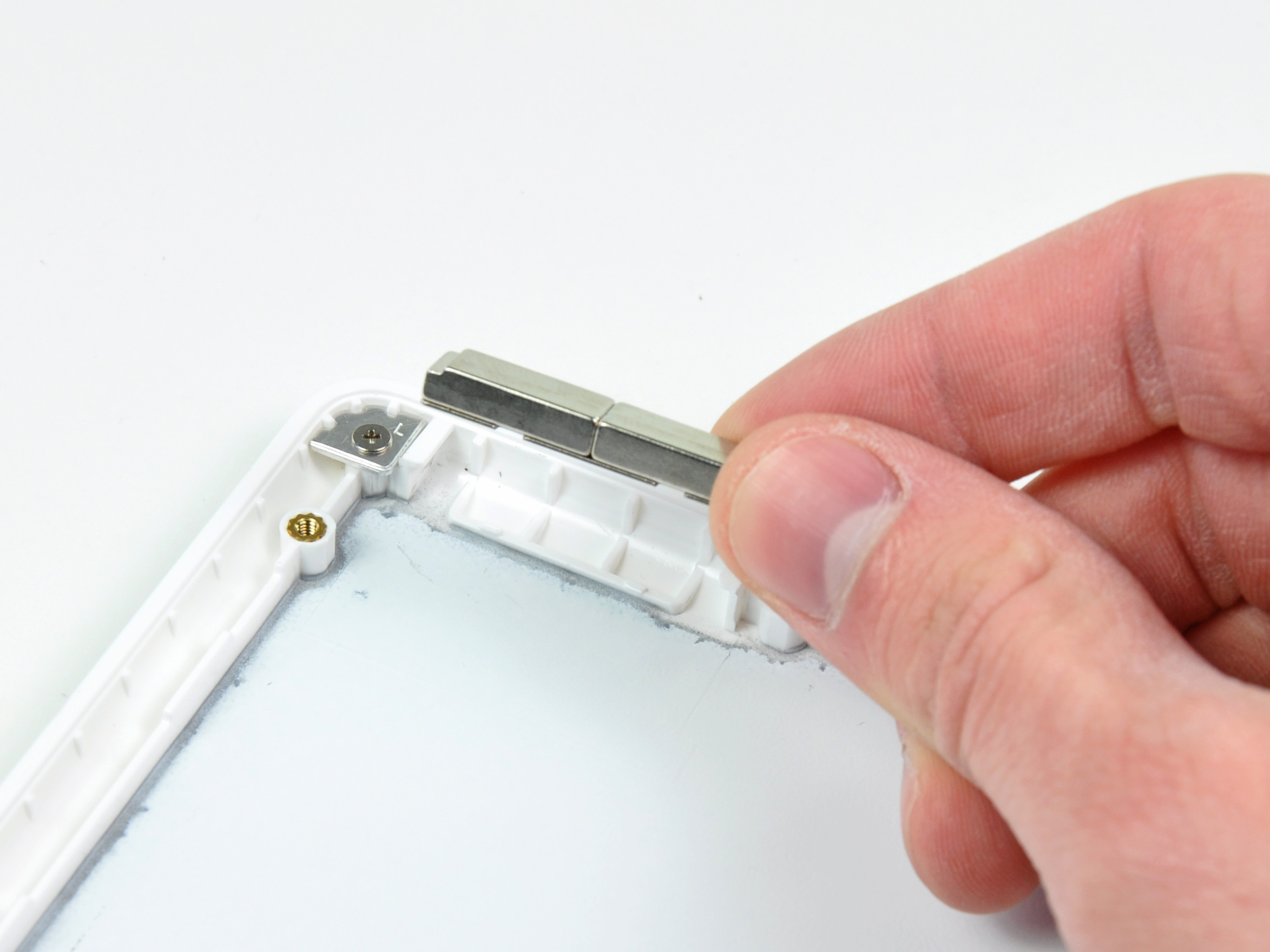

Step 50
Remove the twelve 4.2 mm Phillips screws securing the LCD assembly to the rear display bezel.
Make sure you pay attention to how the microphone cable (and antenna cable on some models) are routed around the outside of the two screws nearest to the bottom of the screen (on both left and right). It's easy to damage the cables if not routed properly when putting these screws back on.
