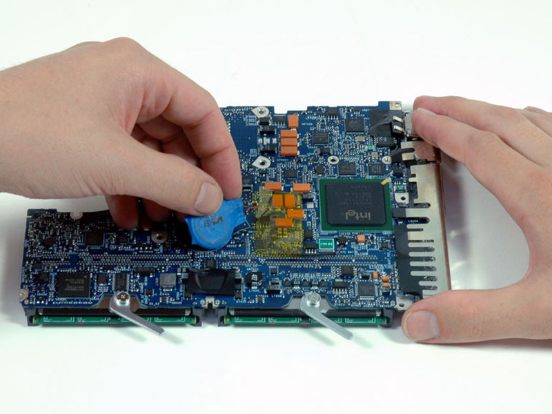

The time and date, as well as other settings, are kept by the PRAM battery when your machine is off. If you feel like you're stuck in the movie Groundhog Day, replace the PRAM battery and finally turn the page of your calendar.

  • Use a coin to rotate the battery-locking screw 90 degrees clockwise.
Image #1
Add Note Edit Step 2  ¶
Image #1
Add Note Edit Step 3 — Memory Cover  ¶
  • Remove the three evenly-spaced Phillips screws from along the rear wall of the battery compartment.
  • The screws are captive to the metal memory cover.
Image #1
Add Note Edit Step 4  ¶
  • Lift up on L-shaped memory cover, slide it to the right, and lift it out of the computer.
Image #1
Add Note Edit Step 5 — Upper Case  ¶
  • Remove the following 3 screws:
    • One 11 mm Phillips #00 in the middle of the case.
    • Two 14.5 mm Phillips #00.
  • If the screws stick in the case, you can use a magnetized screwdriver to draw them out.
  • The shorter of the three screws goes in the middle.
Image #1
Add Note Edit Step 6  ¶
  • Remove the following 3 screws from the rear wall of the battery compartment:
    • Two 3 mm Phillips #00.
    • One 4 mm Phillips #00 on the right side.
  • When reinstalling these screws, press gently on the lower case to line up the screw holes.
Image #1
Add Note Edit Step 7  ¶
  • Remove the two 6 mm Phillips #00 screws from either side of the right wall of the battery compartment (not the ones closest to the battery connector).
Image #1
Add Note Edit Step 8  ¶
  • Remove the four 3 mm indicated Phillips #00 screws from the front wall of the battery compartment. When working from the left, remove the 2nd, 4th, 7th and 9th screw.
