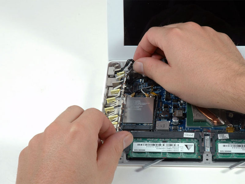

  • Use a coin to rotate the battery-locking screw 90 degrees clockwise.
first image
Add Note Edit Step 2  ¶
first image
Add Note Edit Step 3 — Memory Cover  ¶
  • Remove the three evenly-spaced Phillips screws from along the rear wall of the battery compartment.
  • The screws are captive to the metal memory cover.
