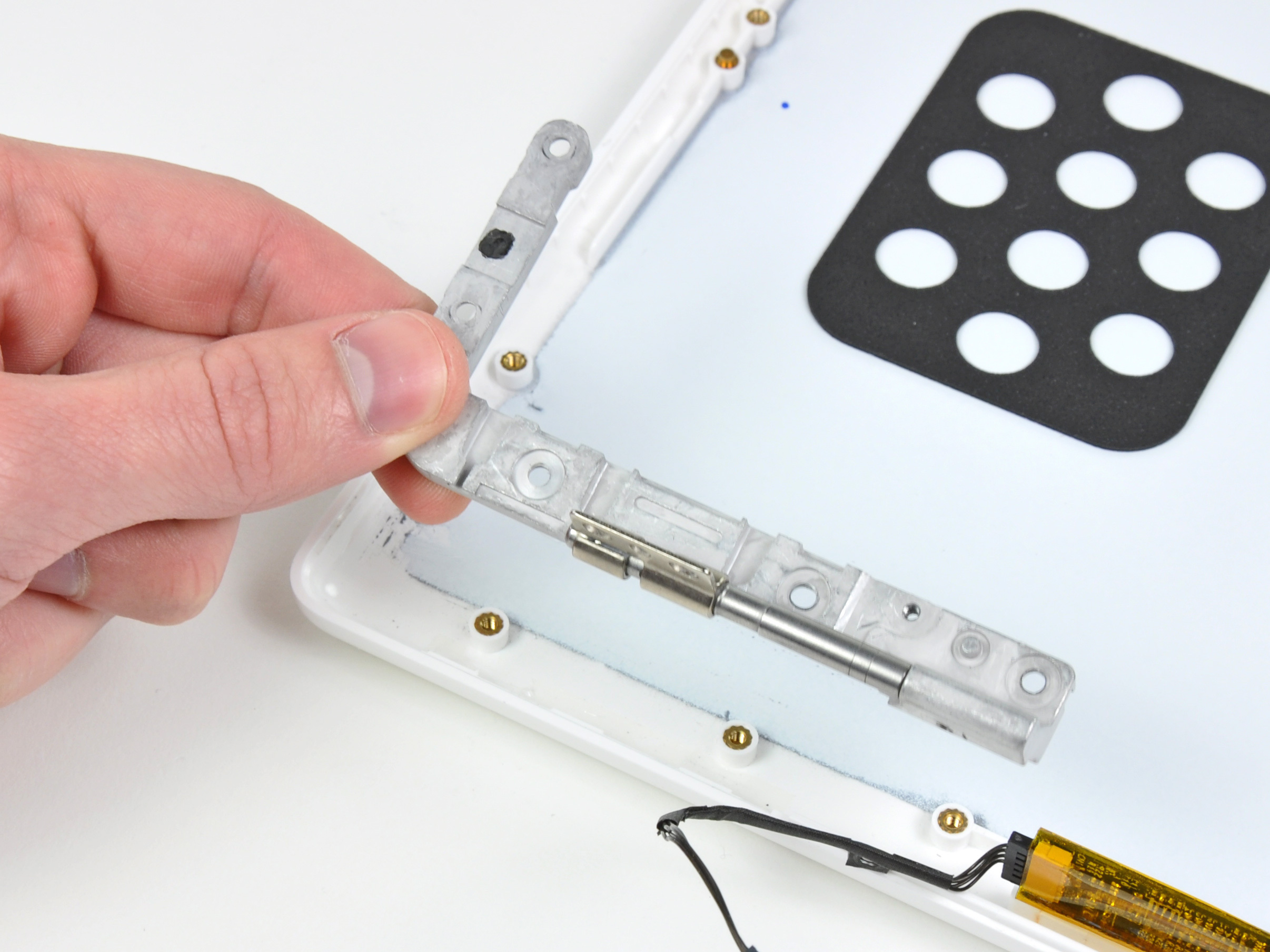

Add Note Edit Step 53 — Left Clutch Hinge  ¶
  • Remove the piece of tape stuck to the left clutch hinge.
first image
Add Note Edit Step 54  ¶
  • Remove the single 3.2 mm Phillips screw securing the inverter cable to the left clutch hinge.

Add Note Edit Step 56  ¶
  • Remove the left clutch hinge from the rear display bezel.
