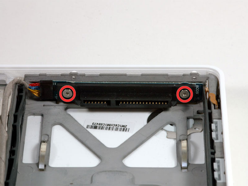

How to remove the hard drive connector.
With the HTML code below, you can embed this guide as a small widget on your website.
Use a coin to rotate the battery-locking screw 90 degrees clockwise.
Lift the battery out of the computer.
Remove the three evenly-spaced Phillips screws from along the rear wall of the battery compartment.
The screws are captive to the metal memory cover.
