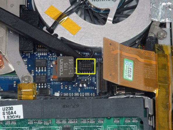

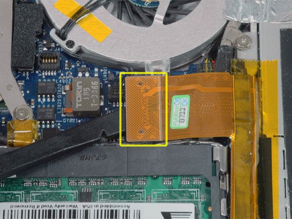

Add Note Edit Step 13 — Fan  ¶
  • Use a spudger to disconnect the orange optical drive cable from the logic board.

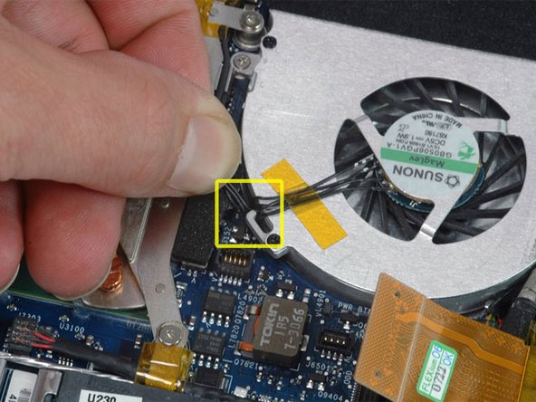

Add Note Edit Step 14  ¶
  • Use a spudger to disconnect the black fan connector from the logic board.
Image #1
Add Note Edit Step 15  ¶
  • Deroute the fan cable from behind the tab on the left side of the fan.

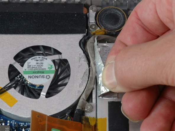

Add Note Edit Step 16  ¶
  • Peel up the silver foil tape between the fan and the optical drive.
