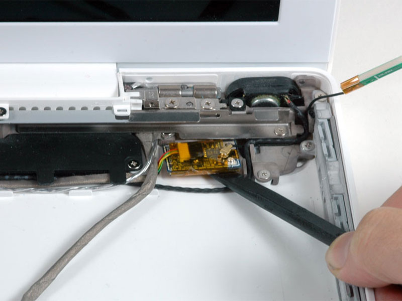

Add Note Edit Step 24 — Bluetooth Board  ¶
  • Use a spudger to disconnect the gold Bluetooth antenna connector from the Bluetooth board.
first image
Add Note Edit Step 25  ¶
  • Pry the Bluetooth board up from the lower case.
first image
Add Note Edit Step 26  ¶
  • Peel back the orange tape covering the Bluetooth board so you can access the data cable connector.
  • Disconnect the data cable from the Bluetooth board.
  • Lift the Bluetooth board out of the computer.
