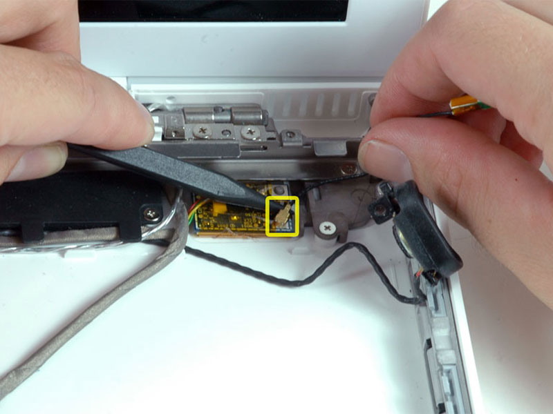

Add Note Edit Step 24 — Bluetooth Antenna  ¶
  • Remove the single Phillips screw securing the right speaker to the lower case.
first image
Add Note Edit Step 25  ¶
  • Lift the right speaker out of its housing and set it to the side.
first image
Add Note Edit Step 26  ¶
  • Use a spudger to disconnect the gold Bluetooth antenna connector from the Bluetooth board.
  • Lift the Bluetooth antenna out of the computer.
