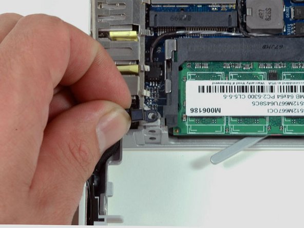

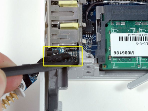

Image #1
Add Note Edit Step 12  ¶
  • While holding up the upper case, use a spudger to pry up the orange trackpad and keyboard cable from its connector.
  • If you happen to break your upper case cable when removing the upper case, we stock the cable individually and we have a guide that makes replacing it easy.

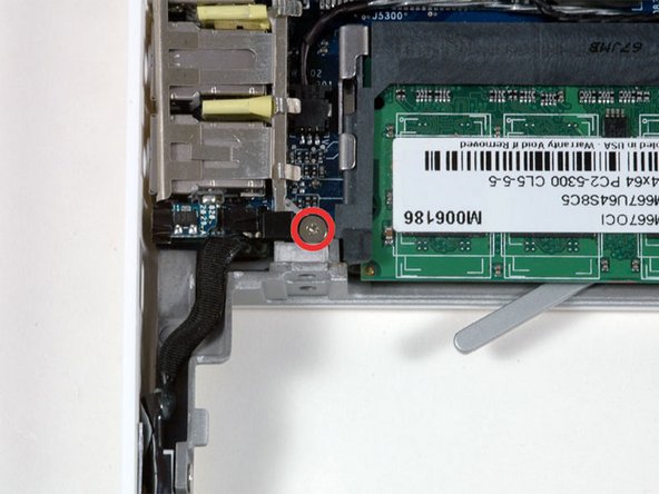

Add Note Edit Step 13 — Battery Connector  ¶
  • Remove the single Phillips screw near the battery connector.

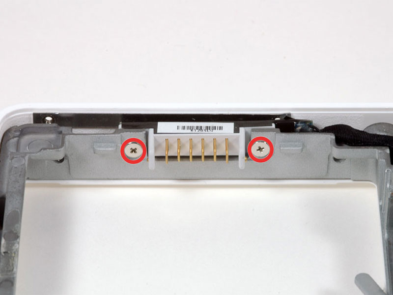

Add Note Edit Step 15  ¶
  • Remove the two Phillips screws attaching the battery connector to the lower case.
