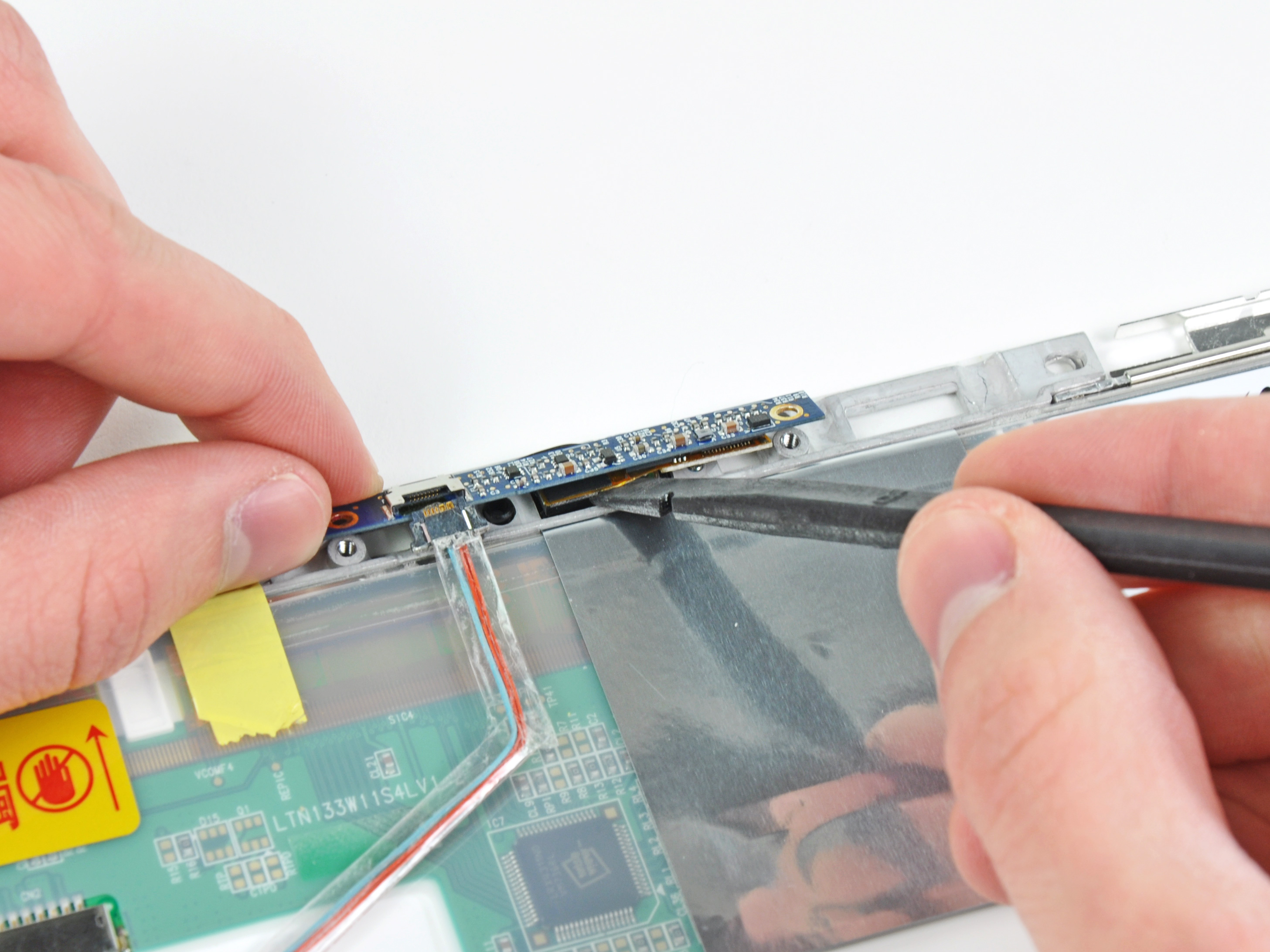

Add Note Edit Step 45 — LCD Assembly  ¶
  • Remove the small piece of foam tape stuck down above each of the bezel covers.
first image
thumb image 1
thumb image 2
Add Note Edit Step 46  ¶
  • Use a spudger to slide the left bezel cover towards the LCD panel.
    • Do not lift up vertically on the cover! Unlike the large display bezel, this one has horizontal hooks to keep it in place. These will break easily.
  • Lift the left bezel cover off the display assembly.
first image
thumb image 1
thumb image 2
Add Note Edit Step 47  ¶
  • Use a spudger to slide the right bezel cover toward the LCD panel.
  • Lift the right bezel cover off the display assembly.

Add Note Edit Step 54 — iSight  ¶
  • Remove the two pieces of yellow tape covering the camera cable near the top edge of the LCD assembly.
first image
Add Note Edit Step 55  ¶
  • Disconnect the camera cable from the iSight board.
first image
