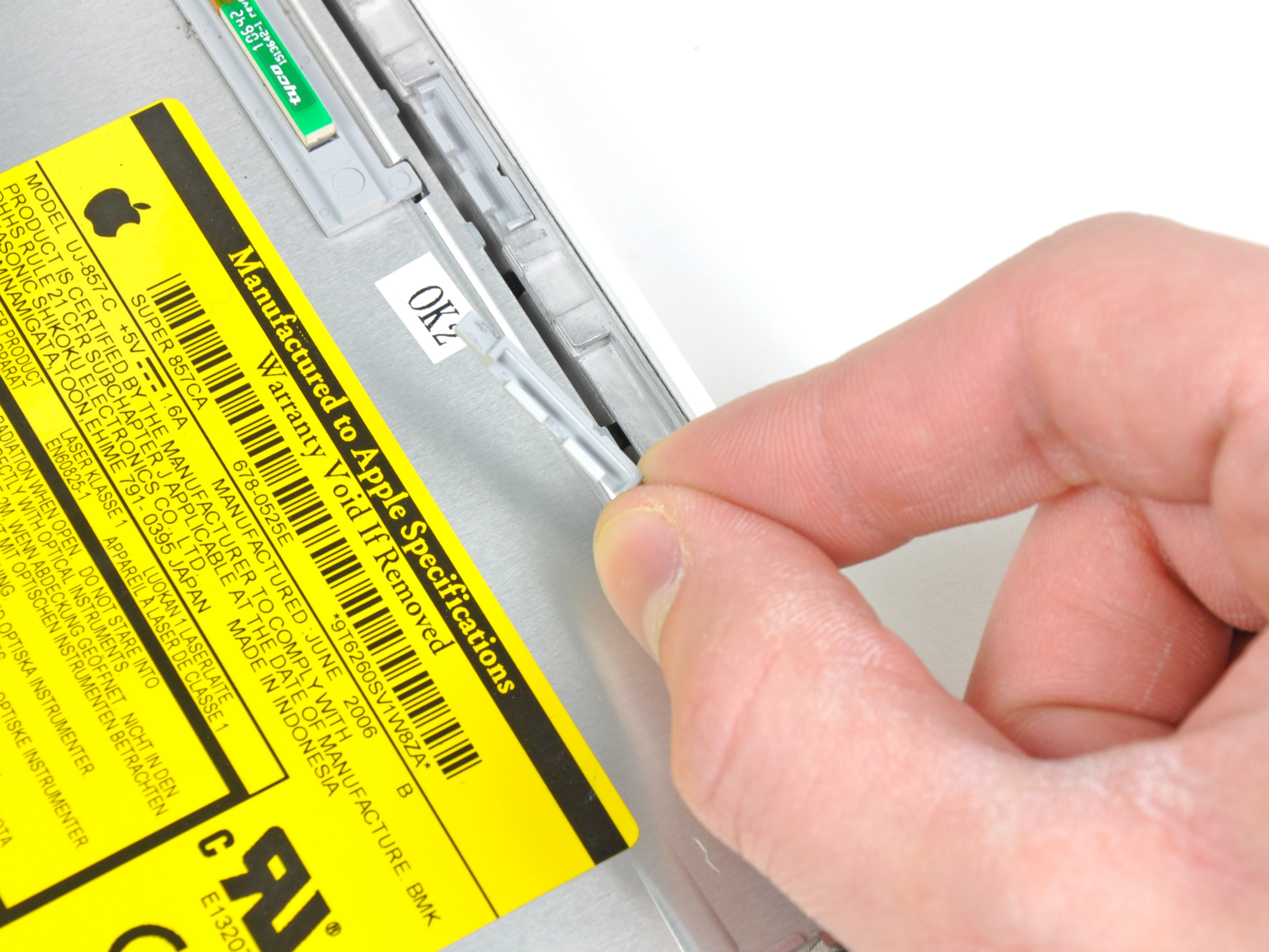

  • Upon reassembly, there are 4 grey plastic clips on the optical drive side of the keyboard. They must be installed in their slots for the keyboard to snap in properly.

Add Note Edit Step 13 — Upper Case Clips  ¶
  • The clips are captive to the lower case on Santa Rosa MacBooks and later and are thus not replaceable on these models.
  • The four plastic upper case clips are installed in the aluminum framework above the optical drive opening.
  • To remove the clips, simply slide them out of the aluminum framework away from the side of the lower case.
