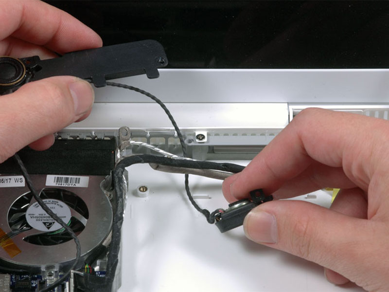

Add Note Edit Step 26  ¶
  • Thread the subwoofer and right speaker beneath the display data and microphone cables.
first image
