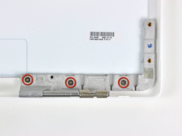

Add Note Edit Step 54 — Right Clutch Hinge  ¶
  • Remove the three 3.2 mm Phillips screws securing the right clutch hinge to the rear display bezel.

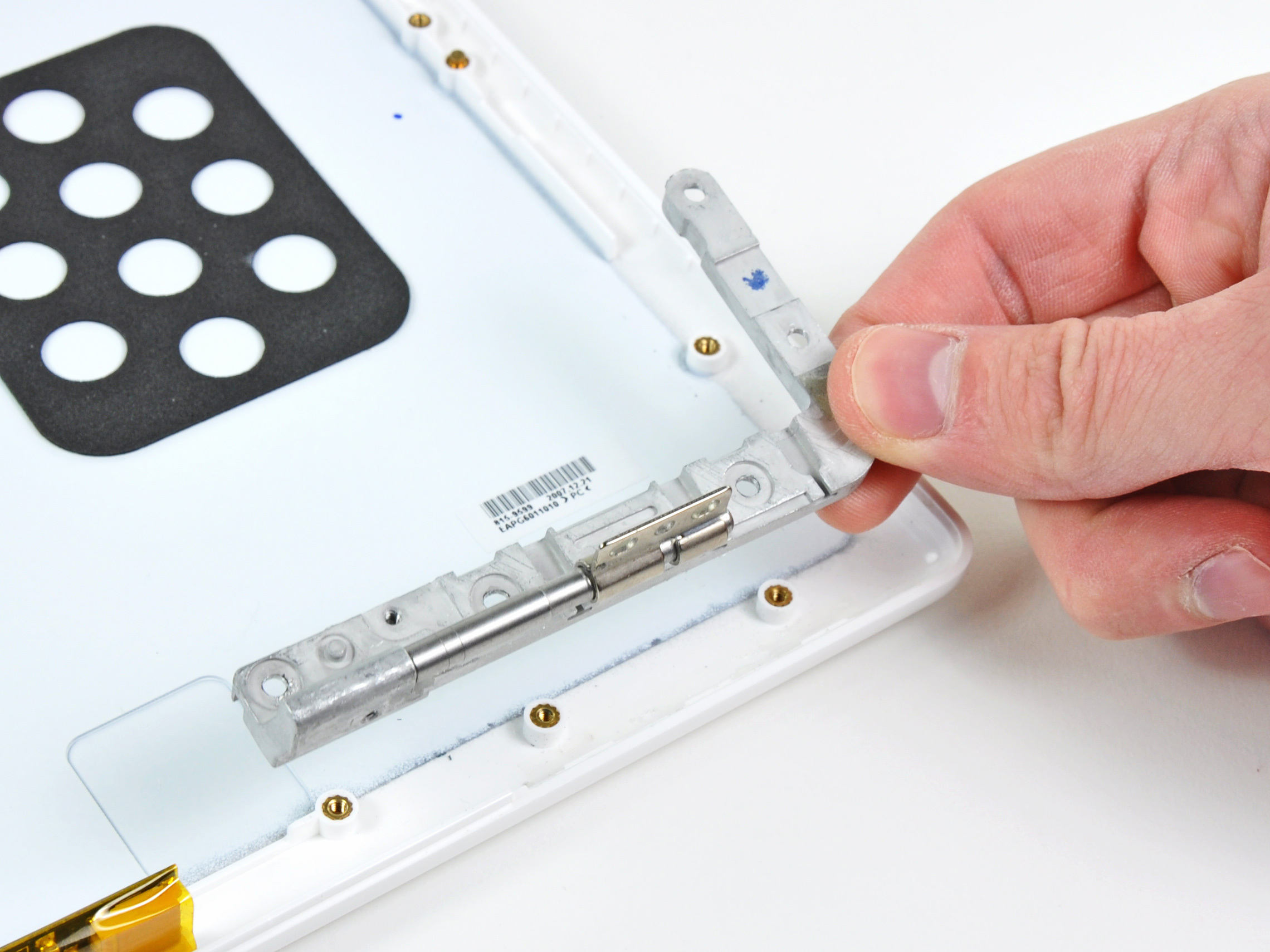

Add Note Edit Step 55  ¶
  • Lift the right clutch hinge out of the rear display bezel.
