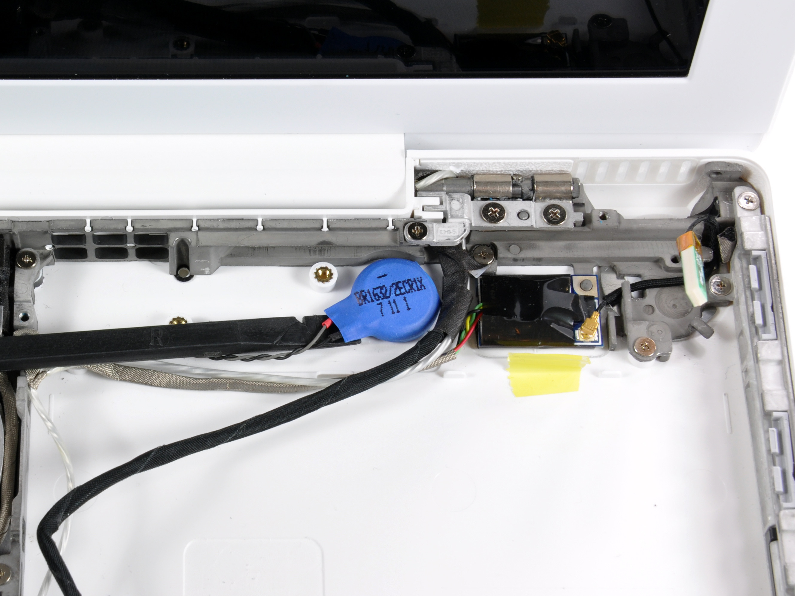

Add Note Edit Step 29 — PRAM Battery (Santa Rosa/Penryn)  ¶
  • Use a spudger to remove the PRAM battery up from its location on the lower case.
  • Disconnect the PRAM battery cable from the logic board and remove the PRAM battery from the computer.
