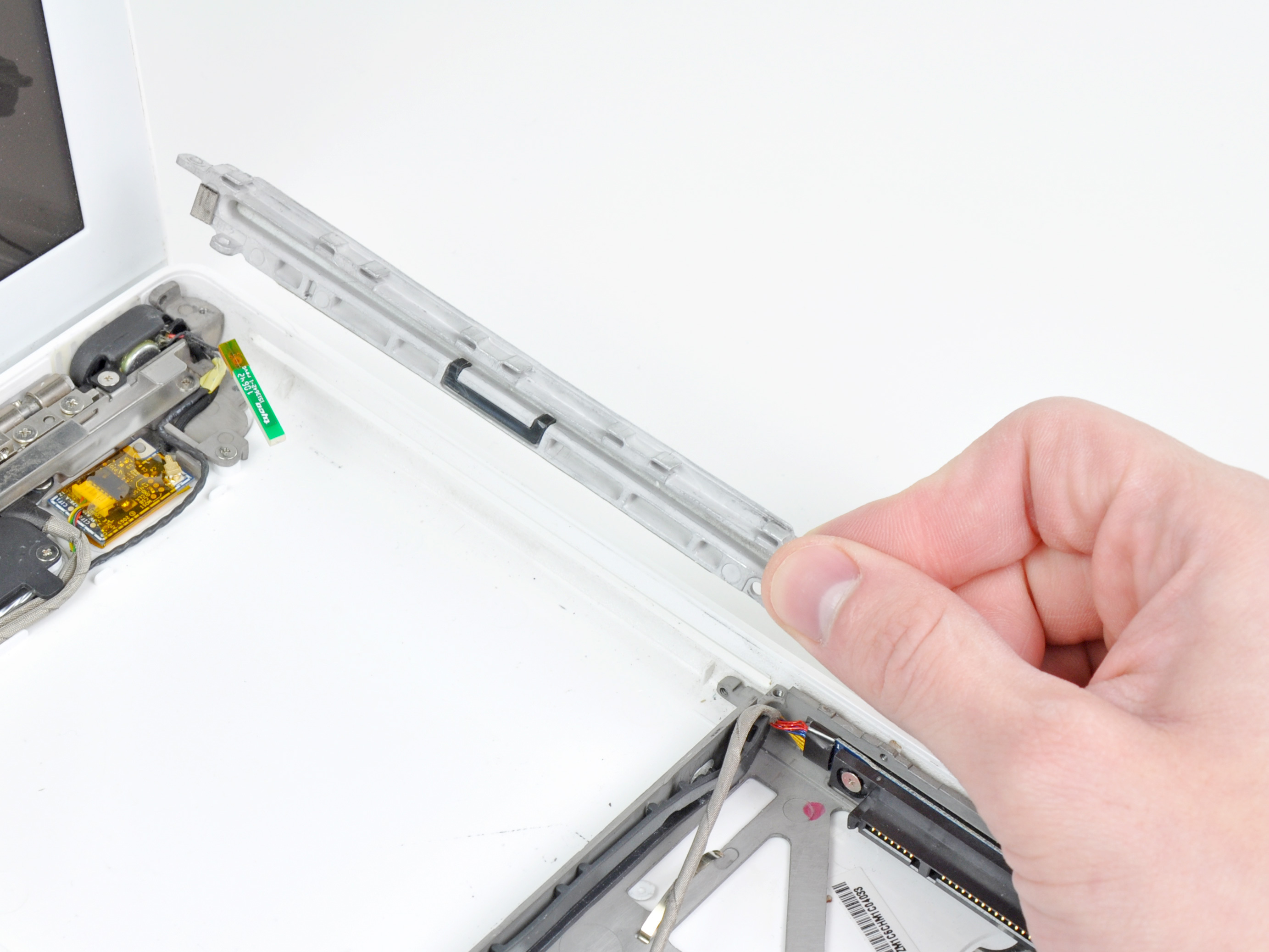

Add Note Edit Step 28  ¶
  • Remove the optical drive bezel from the lower case.
