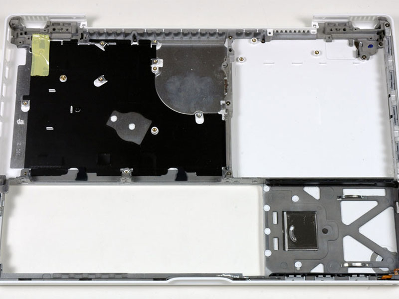

Installing MacBook Core 2 Duo Lower Case
  • Author: iRobot
  • Difficulty: Difficult
  • Add Note x
  • x 15
Replacing the plastic bottom case.

  • Remove the two Phillips screws attaching the battery connector to the lower case.
first image
Add Note Edit Step 49  ¶
  • Remove the single Phillips screw in the upper right corner of the Airport card.
first image
thumb image 1
thumb image 2
Add Note Edit Step 50  ¶
  • Use a spudger to disconnect the right speaker connector and Bluetooth connector from the logic board.
  • On Santa Rosa/Penryn models, the PRAM battery connector must also be removed. See second picture.

Add Note Edit Step 59  ¶
  • Lower case remains.
