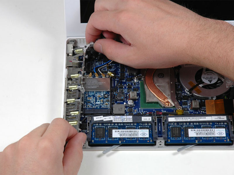

Add Note Edit Step 13 — Left I/O Frame  ¶
  • Disconnect the MagSafe board cable from the logic board by pulling the snap-in connector out (to the right).
first image
Add Note Edit Step 14  ¶
  • Remove the single 9 mm Phillips screw securing the left speaker to the lower case.
  • Lift the left speaker out of its housing and set it to the side.
first image
Add Note Edit Step 15  ¶
  • Remove the following 3 screws:
    • Two 9 mm Phillips from either end of the left I/O frame.
    • One 7.5 mm Phillips from the middle of the left I/O frame.
  • Remove the small black plastic spacer at the bottom of the left I/O frame.
first image
Add Note Edit Step 16  ¶
  • Lift the left I/O frame up and out of the computer. Pay attention to the thin metal EMI fingers, as they may catch as you remove the left I/O frame.
  • The speaker wire may be hooked onto the I/O frame. Lift it out of the catch and don't forget to put it back when you are reversing the procedure.
  • The part of the shield you are removing is attached to other part by little hooks underneath that are hard to see until you have it apart. They're located over the headphone jack and the firewire port
