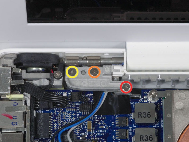

Add Note Edit Step 13 — Left Hinge Mount  ¶
  • Remove the following 3 screws from the left hinge mount:
    • One 6 mm smaller diameter Phillips from the right side.
    • One 6 mm larger diameter Phillips from the middle.
    • One 10 mm Phillips from the left side.
  • Lift the hinge mount and attached plastic dust cover out of the computer.
