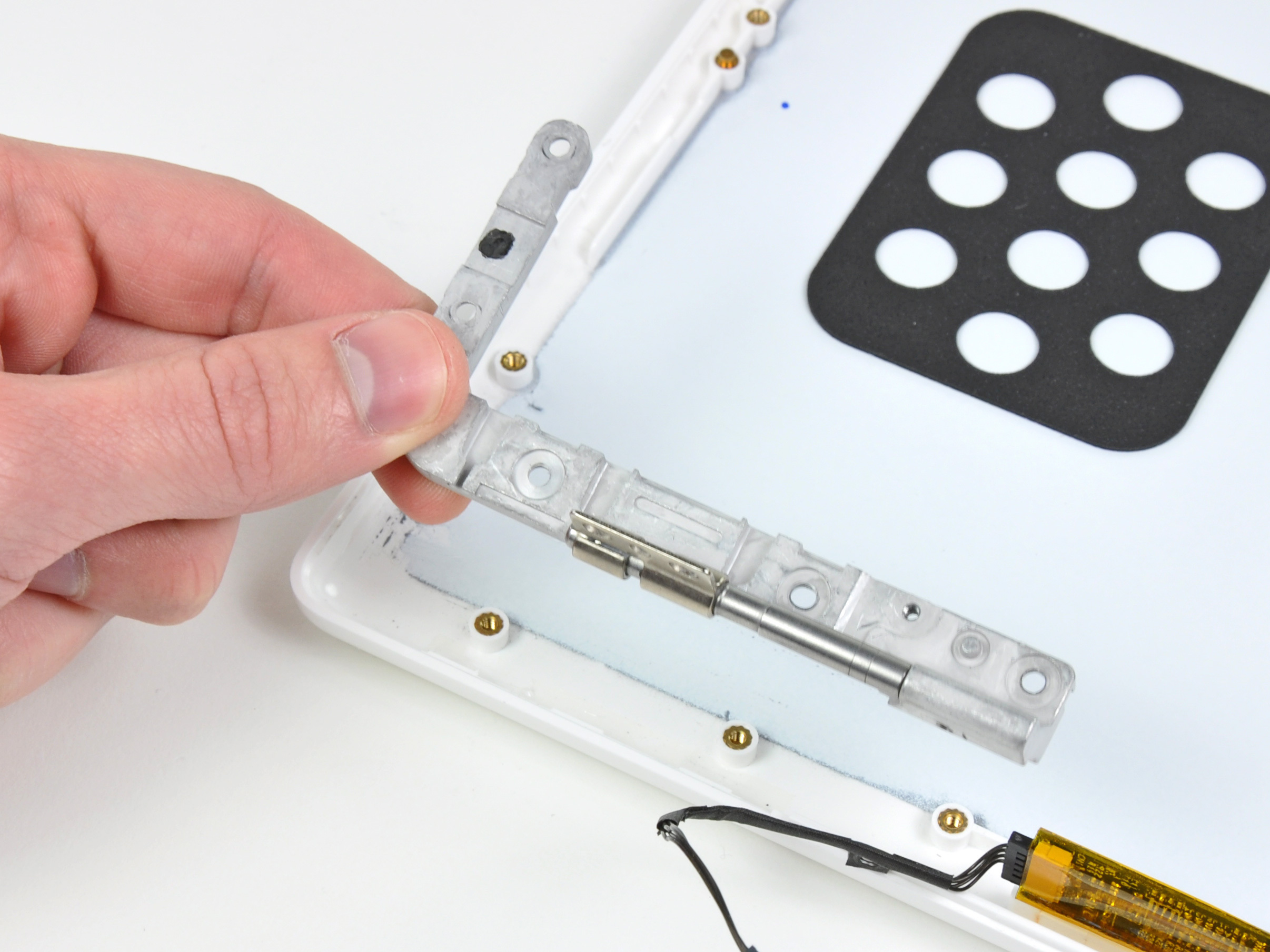

Installing MacBook Core 2 Duo Left Clutch Hinge
Replace a broken left clutch hinge in your MacBook Core 2 Duo.
  • Add Note x
  • x 5
Use this guide to replace a broken left hinge.

Add Note Edit Step 42 — Clutch Cover  ¶
  • Remove the three 4.2 mm Phillips screws securing the clutch cover.
first image
Add Note Edit Step 43  ¶
  • While holding the display down with one hand, use your other hand to lift the clutch cover off the clutch hinges.
  • It may help to wiggle the clutch cover as you pull it up from the display.
first image
Add Note Edit Step 44  ¶
  • Lift up the right side of the clutch cover and guide the display data and iSight cables through the gap in the clutch cover.
  • Lift the clutch cover out of the display assembly.
  • During reassembly, make sure not to pinch the pink and white inverter cable when snapping the clutch cover back into place.
first image

Add Note Edit Step 57  ¶
  • Remove the left clutch hinge from the rear display bezel.
