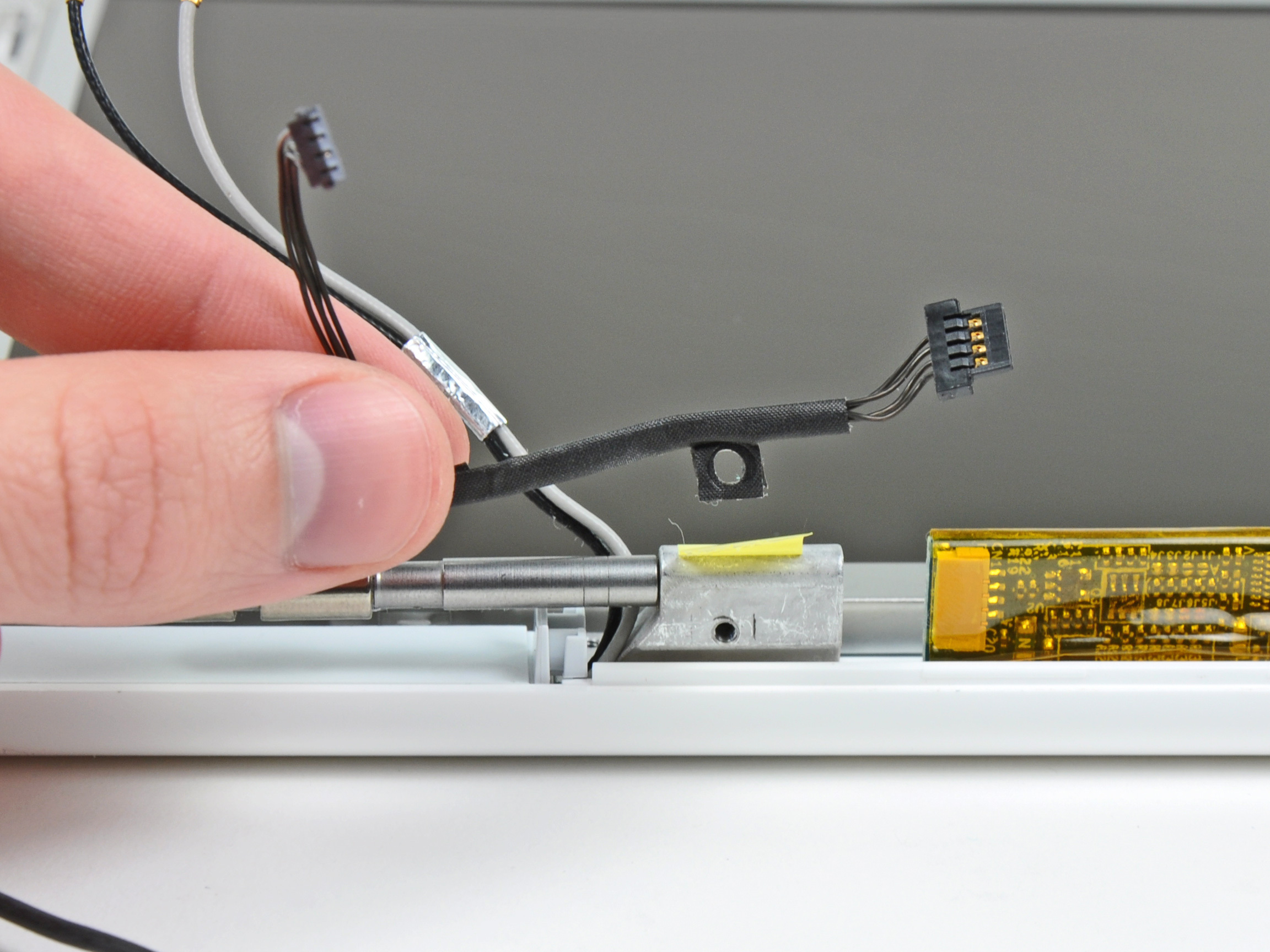

Add Note Edit Step 45 — Inverter Cable  ¶
  • Lift the inverter slightly out of the display.
  • Disconnect the inverter cable from the left side of the inverter board.
  • Set the inverter board back down into its recess molded into the rear display bezel.
first image
Add Note Edit Step 46  ¶
  • Gently peel back the strip of tape covering the inverter cable.
  • Remove the single 3.2 mm Phillips screw securing the inverter cable to the left clutch hinge.
first image

  • Remove the inverter cable from the display.
  • Before ordering a new inverter cable, be sure you are buying one with the correct connector for your machine. The Santa Rosa/Penryn inverter cable has a much slimmer three-wall connector on the side that connects to the logic board.
