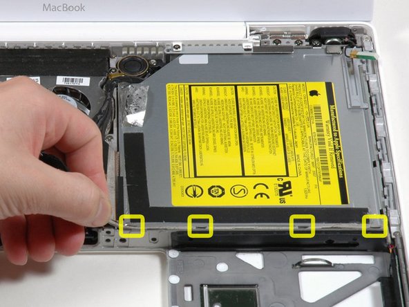

Image #1
Add Note Edit Step 17  ¶
  • Disconnect the (once again) newly-revealed hard drive cable.
Image #1
Add Note Edit Step 18  ¶
  • Peel up the foil tape between the fan and the optical drive. Lift the foil tape from the fan side, leaving it attached to the optical drive.
  • During reassembly, be sure to route the cables beneath the tape before reattaching it.
Image #1
Add Note Edit Step 19  ¶
  • Pull up the display data cable from along the edge of the optical drive to reveal a silver Phillips screw.
Image #1
Add Note Edit Step 20  ¶
  • Remove the 2 mm Phillips #00 screw securing the optical drive.
  • The Bluetooth cable may be covering the screw. If so, carefully push it aside. You may need to unscrew the cable clip to free the cable enough.
Image #1
Add Note Edit Step 21  ¶
  • Lift the Bluetooth antenna board from the right side of the optical drive.
Image #1
Add Note Edit Step 22  ¶
  • Deroute the hard drive cable from along the front of the optical drive.
Image #1
Add Note Edit Step 23  ¶
  • Lift the front edge of the optical drive and slide it up and out of the computer.
Image #1
Add Note Edit Step 24 — C-Channel  ¶
  • Remove the following 3 screws:
    • Two 3 mm Phillips near the right speaker.
    • One 6 mm Phillips threaded through a hole in a plastic finger above the subwoofer.
  • Be careful not to over-tighten the screw above the subwoofer too tight or the plastic could crack.
  • Santa Rosa and Penryn MacBooks do not have a c-channel. If you are disassembling either of these models, remove only the 3 mm Phillips screw from the right speaker and skip step 26.
