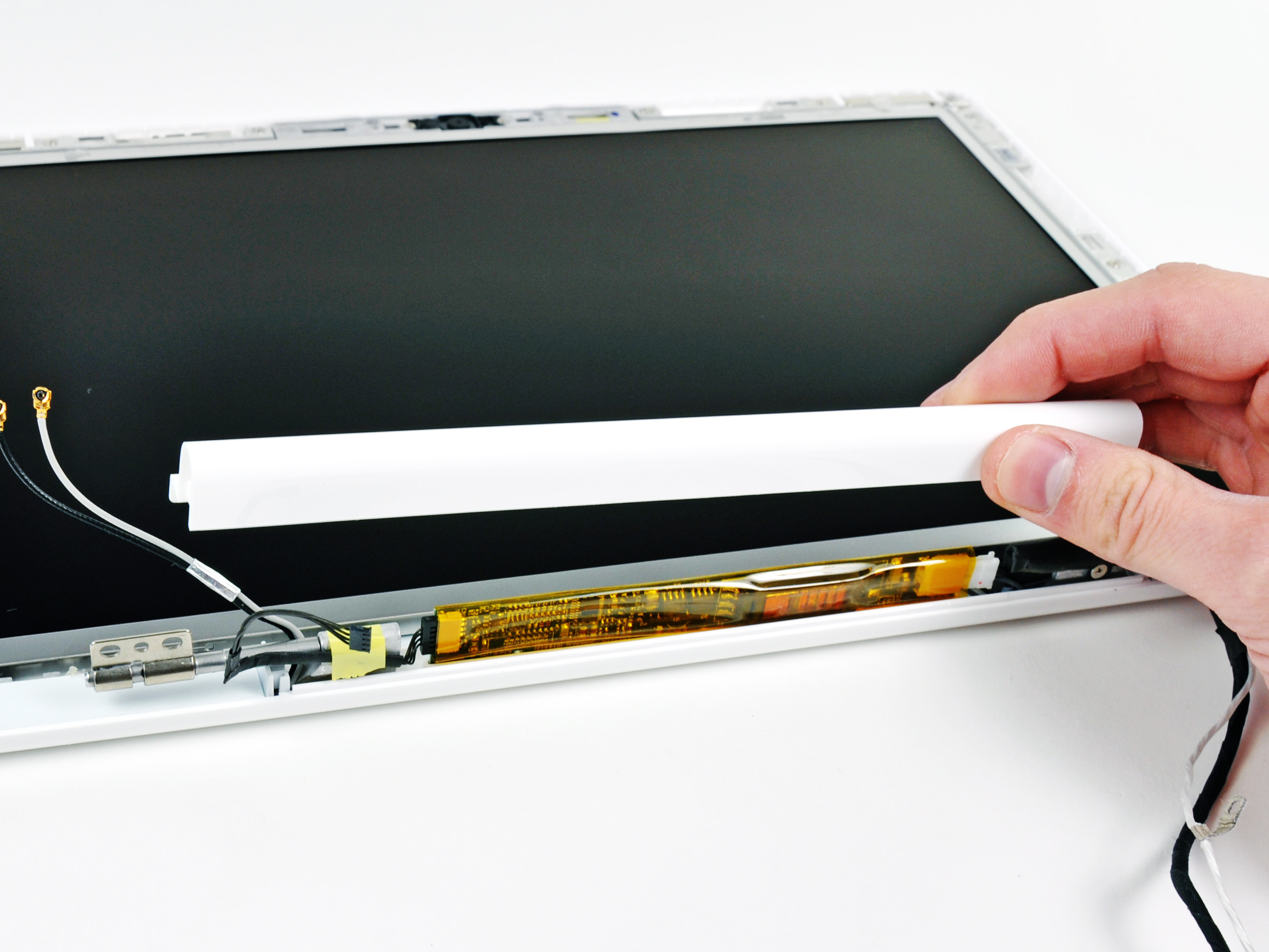

Installing MacBook Core 2 Duo Clutch Cover
Replace the clutch cover on your MacBook Core 2 Duo.
- Author: Ben Eisenman
- Difficulty: Difficult
Replace the curved plastic piece beneath the LCD.

Step 5
Upper Case
Remove the following 3 screws:
One 11 mm Phillips#00 in the middle of the case. (Head: 5mm dia. x .75mm thick)
Two 14.5 mm Phillips #00 (Head: 5mm dia. x .75mm thick)
If the screws stick in the case, you can use a magnetized screwdriver to draw them out.
The shorter of the three screws goes in the middle.
