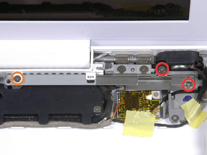

Add Note Edit Step 24 — C-Channel  ¶
  • Remove the following 3 screws:
    • Two 3 mm Phillips near the right speaker.
    • One 6 mm Phillips threaded through a hole in a plastic finger above the subwoofer.
  • Be careful not to over-tighten the screw above the subwoofer too tight or the plastic could crack.
  • Santa Rosa and Penryn MacBooks do not have a c-channel. If you are disassembling either of these models, remove only the 3 mm Phillips screw from the right speaker and skip step 26.
first image
Add Note Edit Step 25  ¶
  • Lift the right speaker out of its housing and set it to the side.
first image
Add Note Edit Step 26  ¶
  • If you have a Santa Rosa/Penryn model, skip this step.
  • Using a spudger, gently pry up the white plastic slot and slide the metal c-channel to the right and away from the display.
