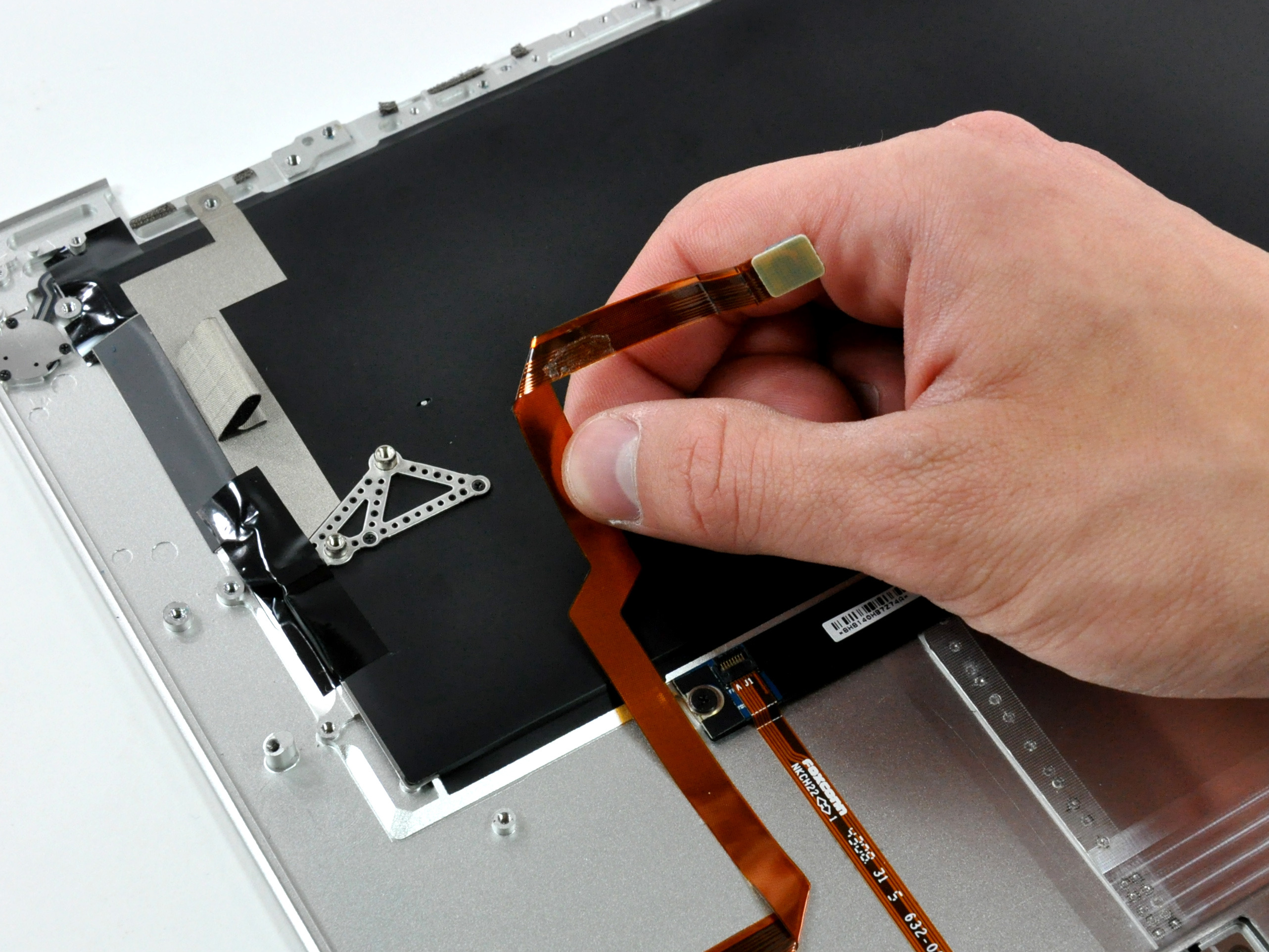

Add Note Edit Step 39  ¶
  • Use the pointed end of a spudger to flip up the retaining flap on the trackpad control cable socket.
  • Peel the trackpad control cable off the adhesive securing it to the upper case.
  • Pull the trackpad control cable out of its socket.
