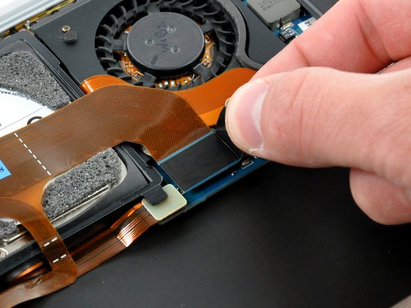

Add Note Edit Step 9 — Port Hatch Assembly  ¶

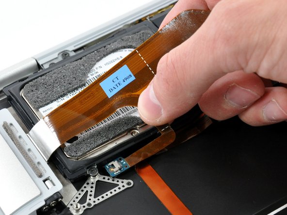

  • Disconnect the port hatch ribbon cable from the logic board by pulling it straight up by its black pull tab.
  • If necessary, pull the audio out ribbon cable off the adhesive securing it to the upper case.

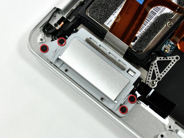

Image #1 Image #2
Add Note Edit Step 10  ¶

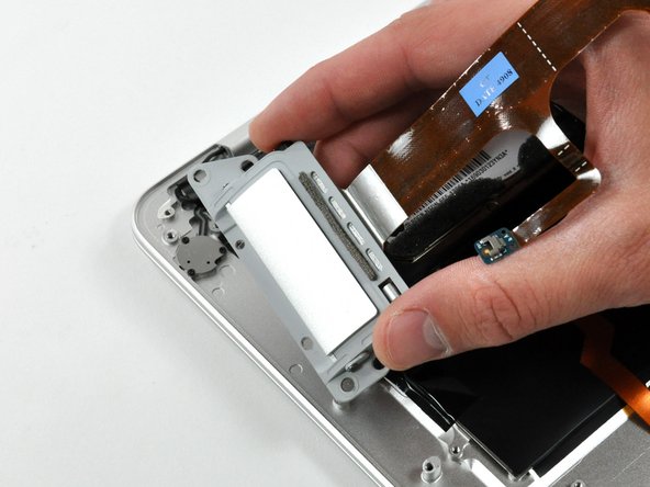

  • Remove the four 3.2 mm Phillips screws securing the port hatch assembly to the upper case.
  • Lift the port hatch assembly out of the upper case.
