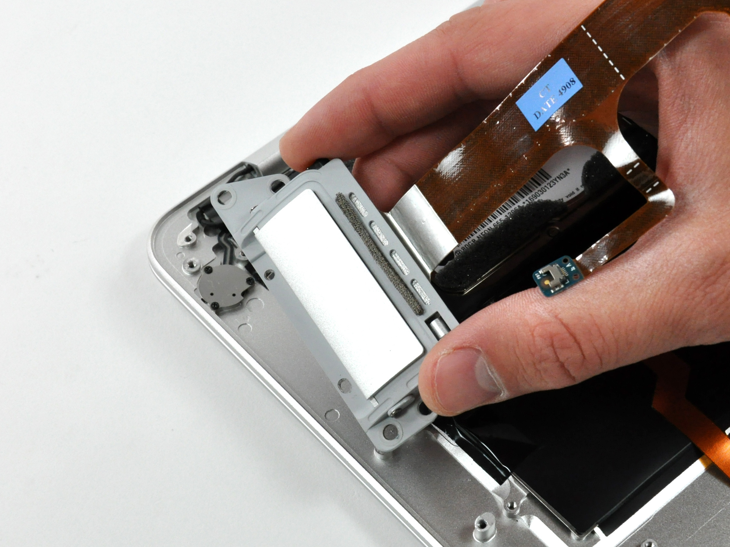

Add Note Edit Step 10  ¶
  • Remove the four 3.2 mm Phillips screws securing the port hatch assembly to the upper case.
  • Lift the port hatch assembly out of the upper case.
