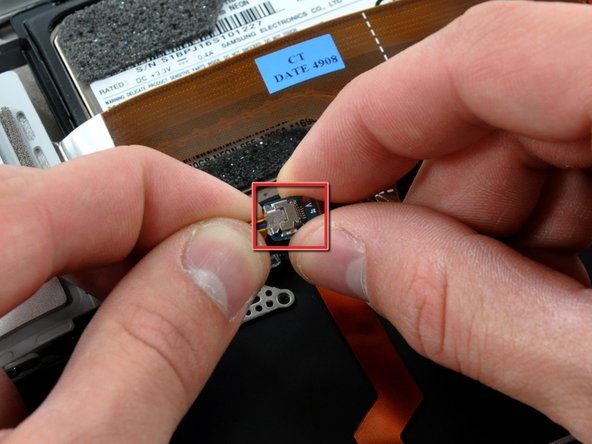

Add Note Edit Step 8  ¶
  • Use a spudger to pry the hard drive cable connector up off the logic board.
first image

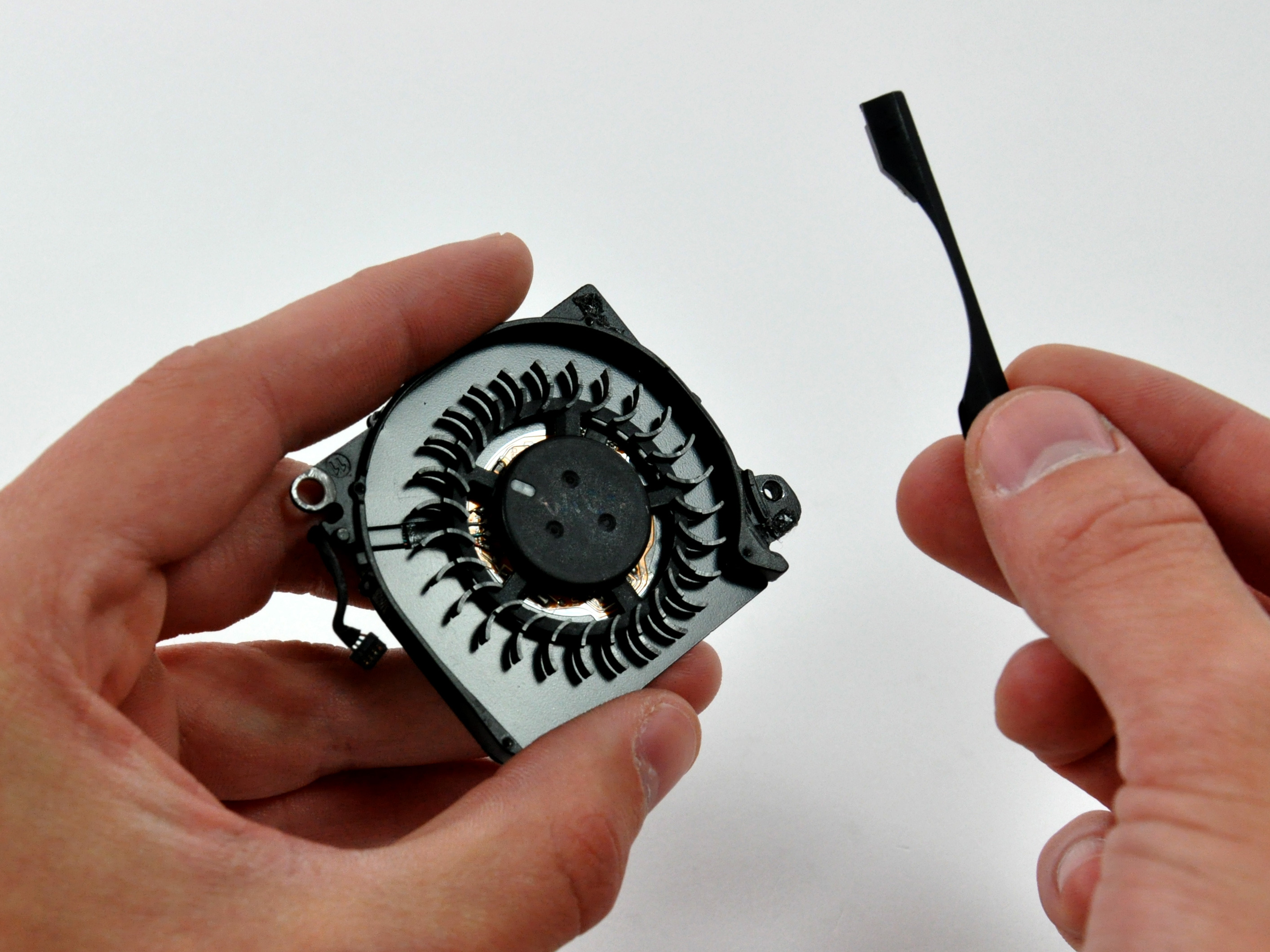

Add Note Edit Step 20  ¶
  • Lift the cosmetic fan bracket out of the fan.
  • Fan remains.
