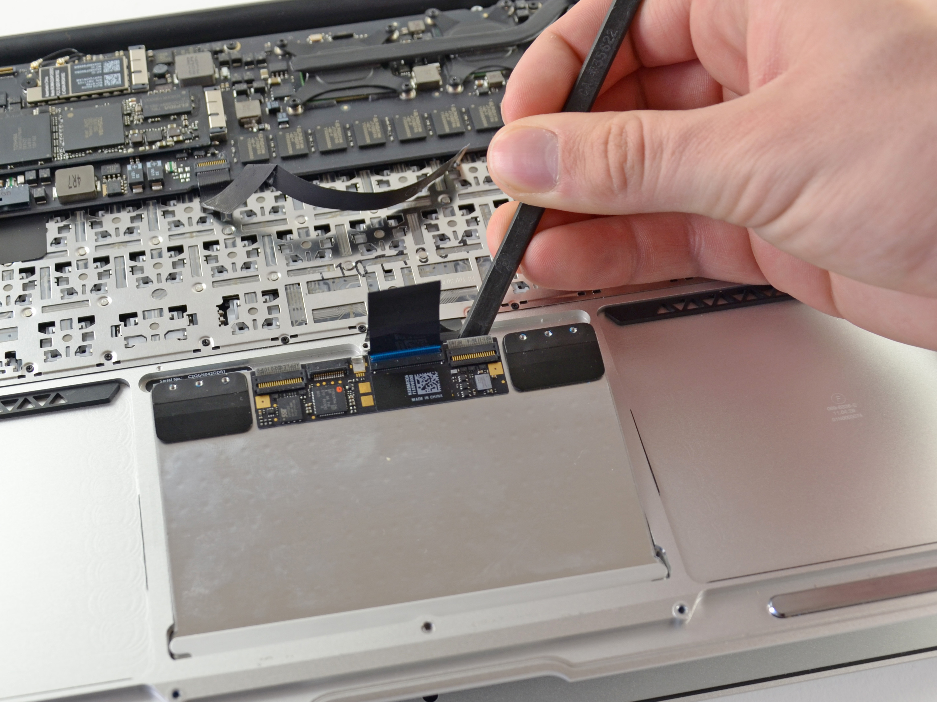

Add Note Edit Step 6 — Trackpad Replacement  ¶
  • Use the tip of a spudger or your fingernail to flip up the retaining flap on the trackpad ribbon cable ZIF socket.
  • Pull the trackpad ribbon cable straight out of its socket toward the rear edge of the Air.

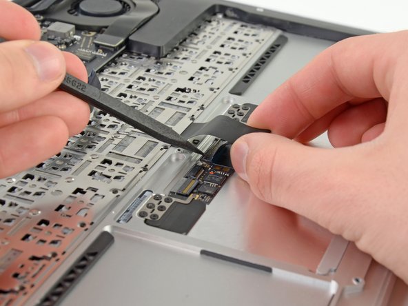

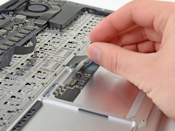

Add Note Edit Step 7  ¶
  • While carefully lifting the keyboard ribbon cable with one hand, use the tip of a spudger or your fingernail to flip up the retaining flap on the keyboard ribbon cable ZIF socket.
  • Pull the keyboard ribbon cable straight out of its socket toward the front edge of the Air.

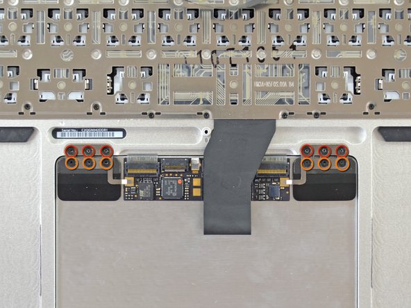

  • Remove the following twelve screws:
    • Six 1.6 mm Phillips screws securing the the trackpad to the upper case.
    • Six 1.6 mm Phillips screws securing the trackpad brackets to the trackpad.
