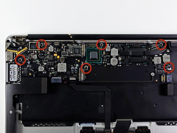

Add Note Edit Step 25  ¶
  • Remove the six 6.3 mm T5 Torx screws securing the logic board to the upper case.
Image #1

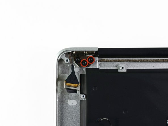

Add Note Edit Step 26  ¶
  • Remove the inner two 4.9 mm T8 Torx screws securing the antenna cable retainer and left clutch hinge to the upper case.
Image #1
Add Note Edit Step 27  ¶
  • Push the antenna cable retainer away slightly and remove the 3 mm T5 Torx screw securing the end of the heat sink to the upper case.

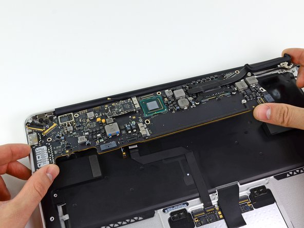

  • Carefully remove the logic board assembly from the upper case, minding any cables that may get caught.
  • Hold the antenna cables out of the way as you lift the heat sink end of the logic board out of the upper case.

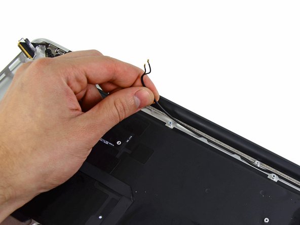

Add Note Edit Step 29 — Display Assembly  ¶
  • Gently de-route the antenna cables out of the channel cut into the upper case.

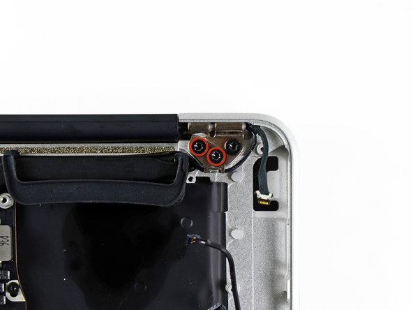

Add Note Edit Step 30  ¶
  • Remove the inner two 4.9 mm T8 Torx screws securing the right display hinge to the upper case.
  • We intentionally have you leave the third screw in to aid in future steps.

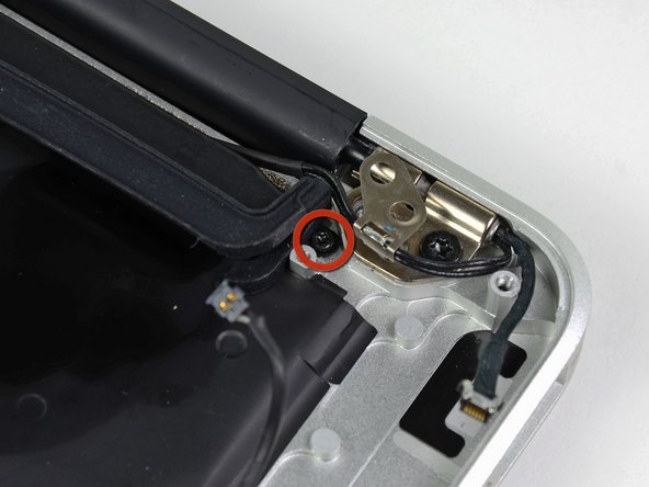

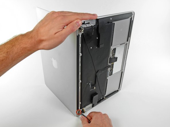

Image #1

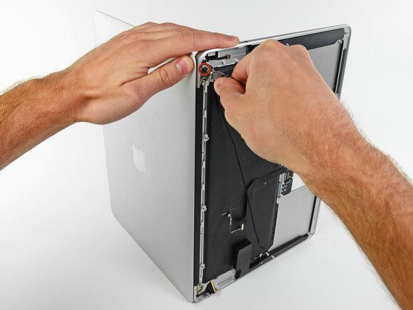

Add Note Edit Step 31  ¶
  • Open the display until it is perpendicular to the upper case and place it on a table as shown.
  • While holding the Air steady, remove the remaining 4.9 mm T8 Torx screw from the lower display bracket.
Image #1
Add Note Edit Step 32  ¶
  • Before removing the last display screw, be sure to hold the display and upper case steady with your other hand. Failure to do so may allow the components to fall onto the table, causing potentially expensive damage.
  • Remove the last 4.9 mm T8 Torx screw securing the display to the upper case.
