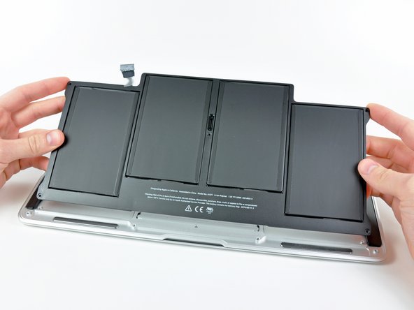

Add Note Edit Step 17  ¶
  • When handling the battery, avoid squeezing or touching the four exposed lithium polymer cells.
  • Lift the battery from its edge nearest the logic board and remove it from the upper case.

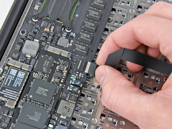

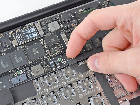

Add Note Edit Step 18 — Logic Board  ¶
  • Use the tip of a spudger or your fingernail to flip up the retaining flap on the trackpad ribbon cable ZIF socket.
  • Pull the trackpad ribbon cable straight out of its socket toward the front edge of the Air.

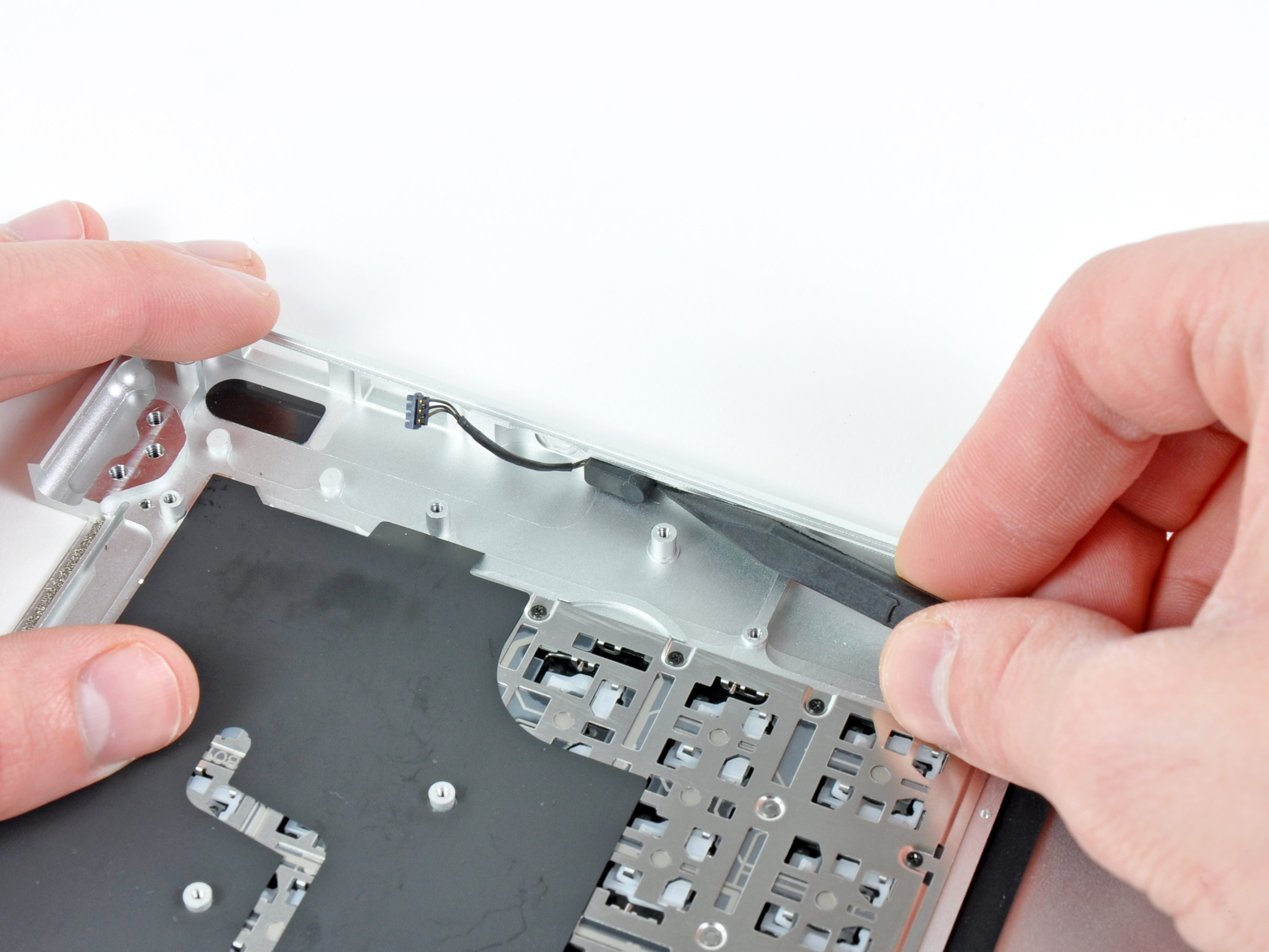

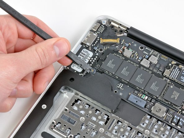

Add Note Edit Step 19  ¶
  • Use the flat end of a spudger to pry the right speaker cable connector up and out of its socket on the logic board.
  • Pry up from beneath the cables.

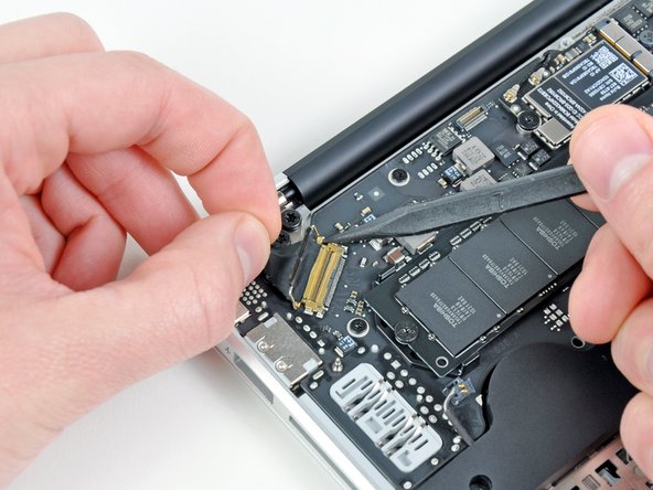

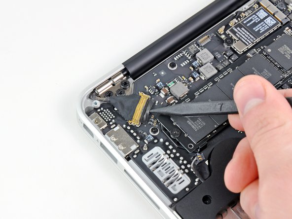

Add Note Edit Step 20  ¶
  • Gently push the tip of a spudger under the black plastic flap stuck to the display data cable lock to make the lock pop upward and away from the socket.
  • While holding the lock away from the socket, use the tip of a spudger and your fingers to gently remove the display data cable from its socket.
  • Do not pull upward on the display data cable as you disconnect it, as its socket may break off the logic board.

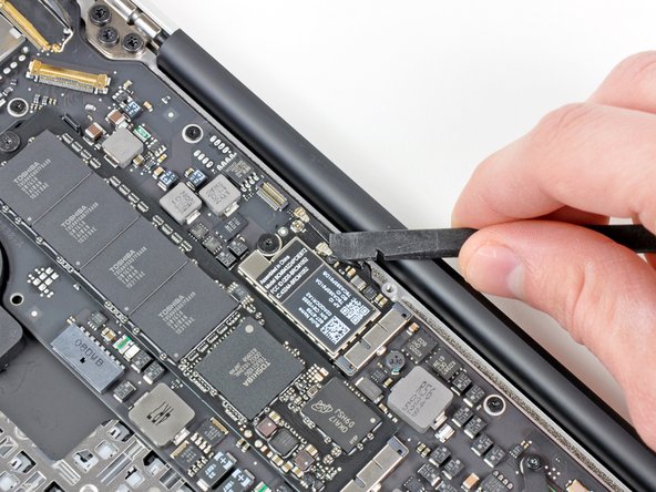

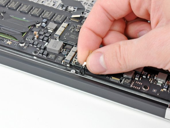

Add Note Edit Step 21  ¶
  • Use the flat end of a spudger to pry both antenna cable connectors up and off their sockets on the AirPort/Bluetooth card.
Image #1
Add Note Edit Step 22  ¶
  • Gently de-route the antenna cables from the slot cut into the logic board.
Image #1

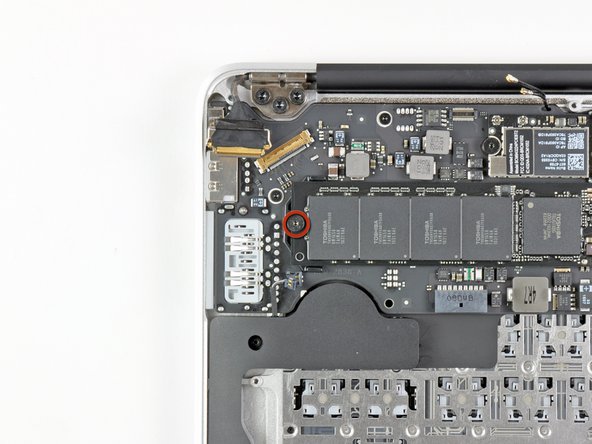

Add Note Edit Step 23  ¶
  • Remove the single 2.85 mm T5 Torx screw securing the SSD to the logic board.
Image #1
Add Note Edit Step 24  ¶
  • Do not lift the end of the SSD excessively.
  • Pull the drive straight out of its socket and remove it from the logic board.
  • When reinstalling the SSD, be sure it is properly seated before reinstalling its retaining screw.
