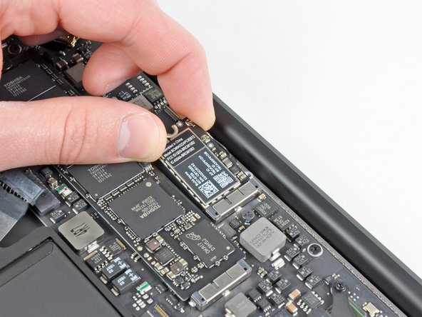

  • Use the flat end of a spudger to pry both antenna connectors up from their sockets on the AirPort/Bluetooth card.
Image #1
Add Note Edit Step 5  ¶

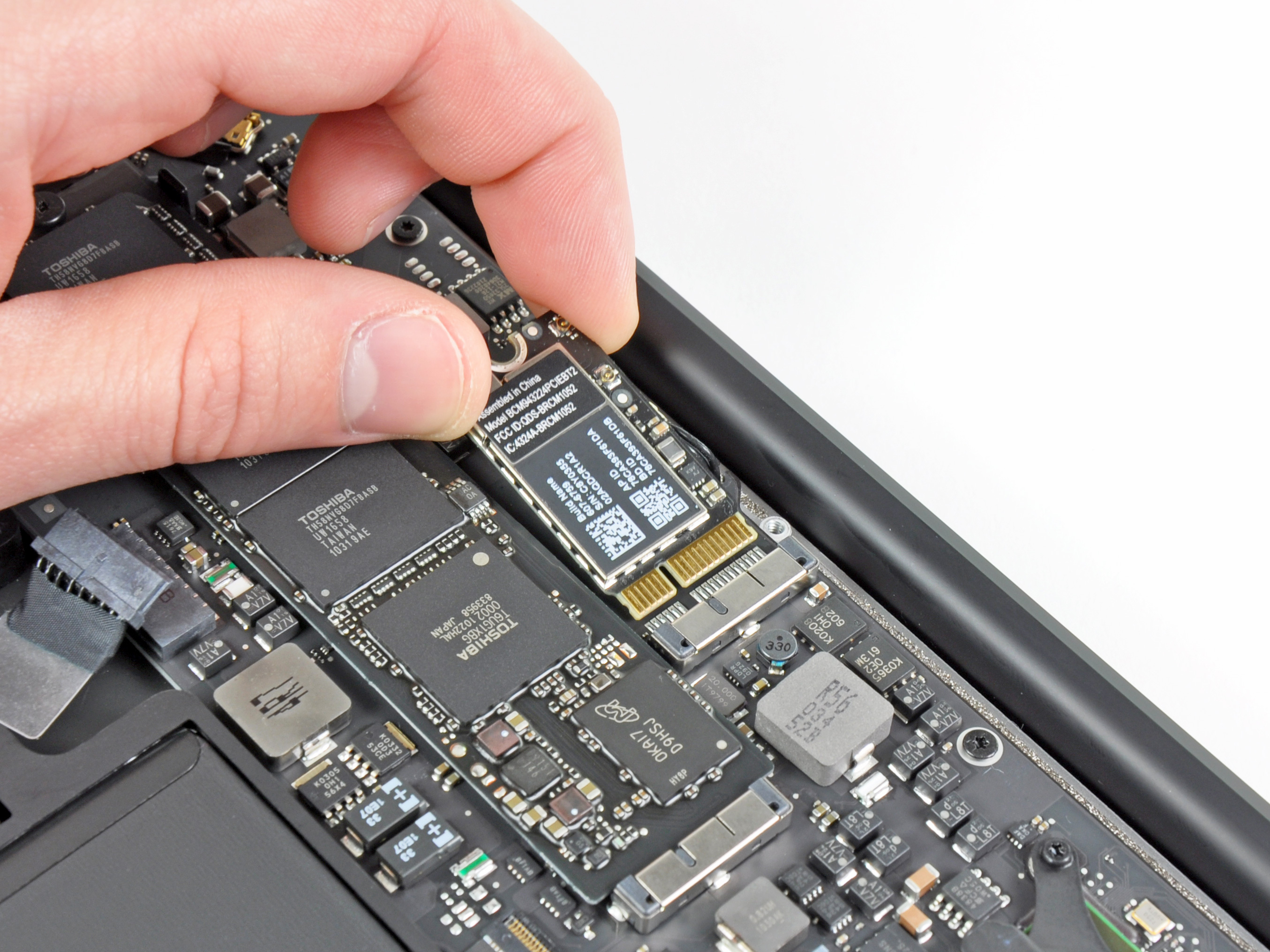

  • Remove the single 2.9 mm T5 Torx screw securing the AirPort/Bluetooth card to the logic board.
Image #1 Image #2
Add Note Edit Step 6  ¶
  • Slightly lift the free end of the AirPort/Bluetooth board and pull it out of its socket on the logic board.
  • Remove the AirPort/Bluetooth board from the Air.
