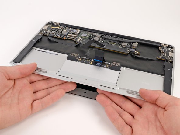

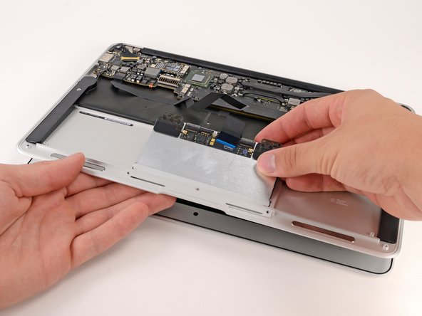

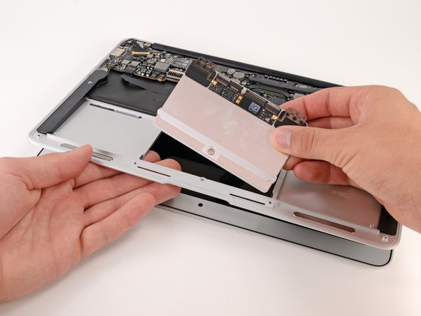

  • Open the device about 10 degrees.
  • While holding the bottom of the trackpad, press up on the side of the trackpad closest to the logic board to free it from the upper case.
  • Remove the trackpad from the device.
