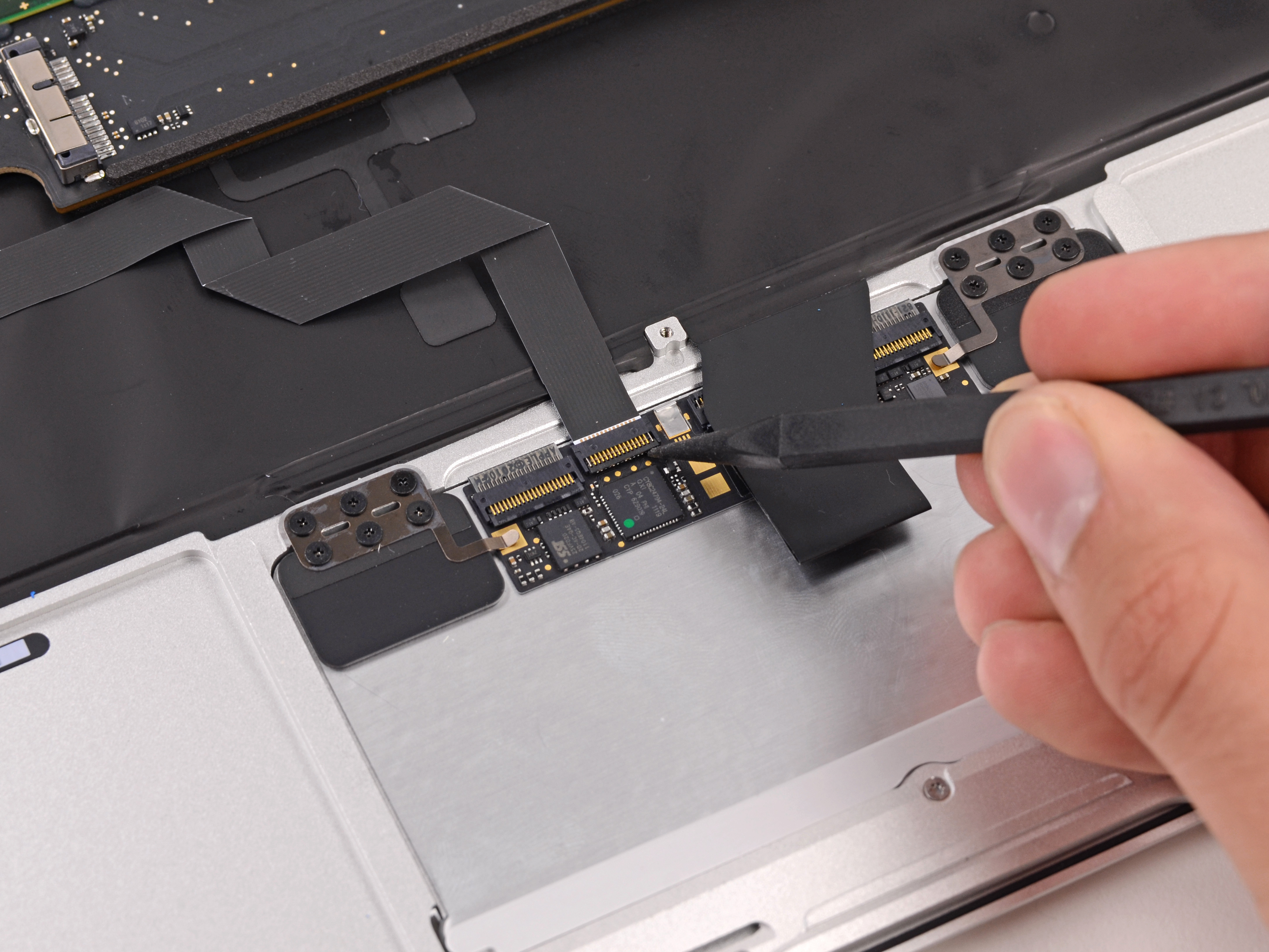

Add Note Edit Step 6 — Trackpad  ¶
  • Use the point of a spudger to lift the ZIF connector retaining flap on the trackpad data cable.
  • Gently slide the ribbon cable out of the ZIF connector.
Image #1 Image #2 Image #3

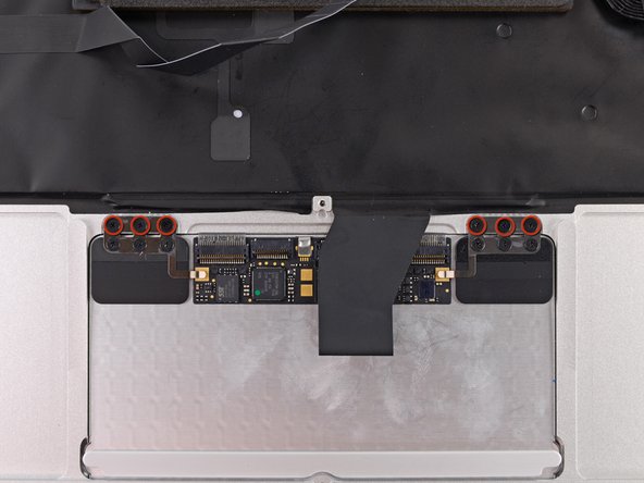

Add Note Edit Step 8  ¶
  • Remove the six 1.5 mm Phillips #00 screws holding the trackpad in place.
