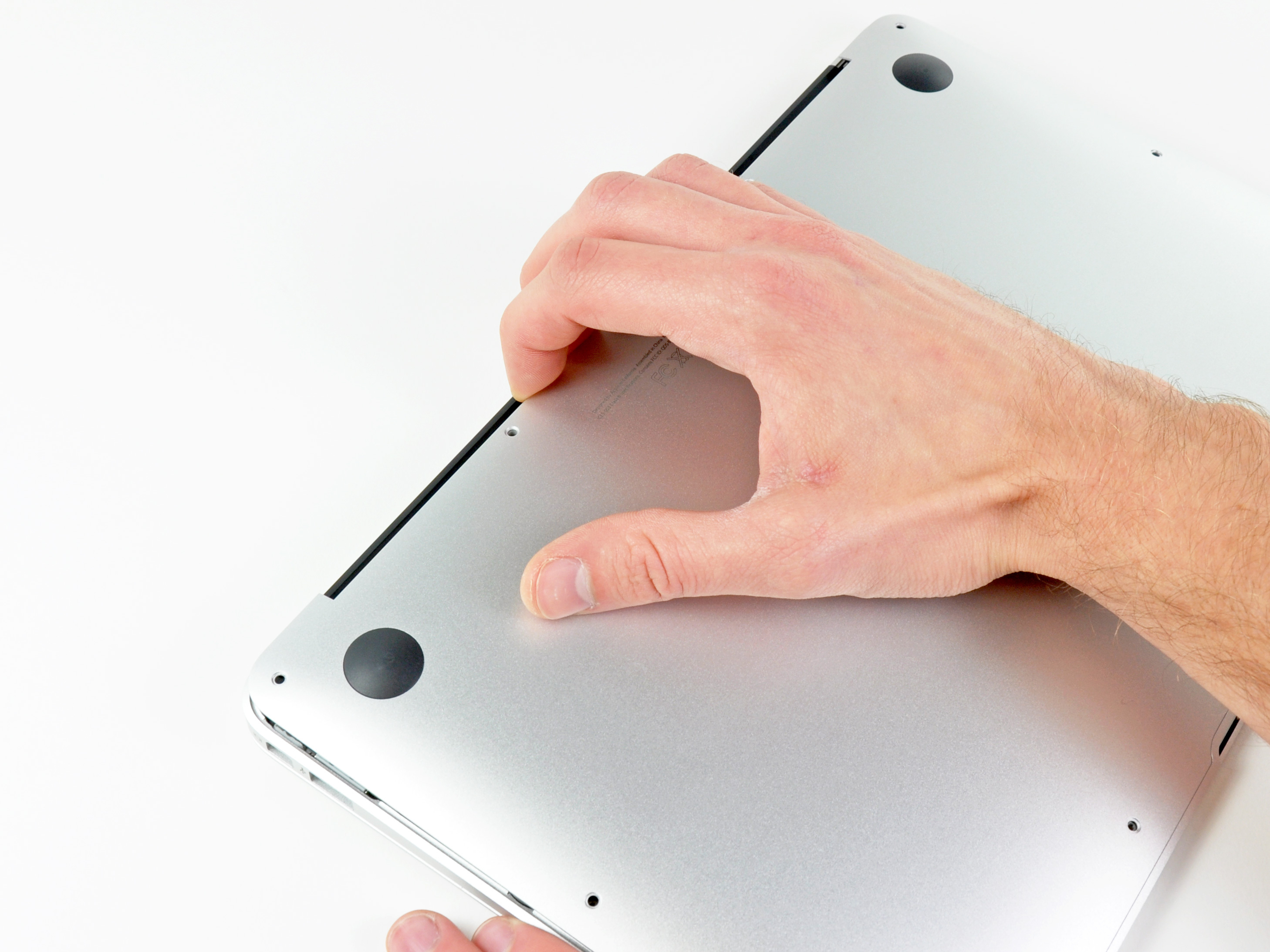

  2. MacBook Air 11" Mid 2011 Lower Case Replacement: step 2, image 1 of 1
    • Wedge your fingers between the display and the lower case and pull upward to pop the lower case off the Air.
