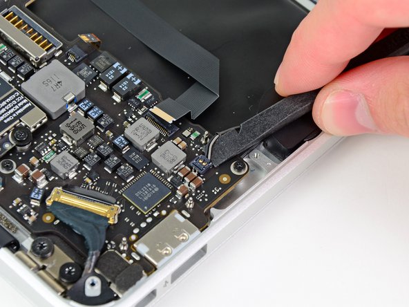

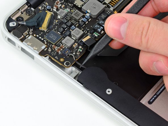

Add Note Edit Step 17  ¶
  • Use the tip of a spudger to de-route the right speaker cable from the slot cut into the logic board.
Image #1
Add Note Edit Step 18  ¶
  • Use the flat end of a spudger to pry the right speaker cable connector up and out of its socket on the logic board.
  • Pry up from beneath the cables.

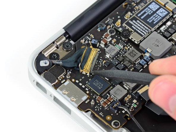

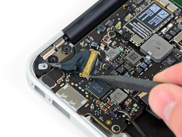

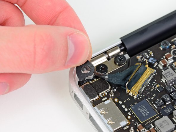

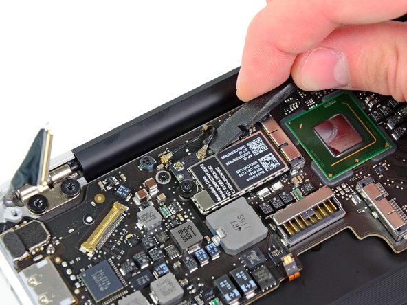

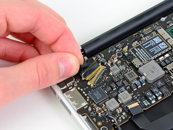

Add Note Edit Step 19  ¶
  • Gently push the tip of a spudger under the black plastic flap stuck to the display data cable lock to make the lock pop upward and away from the socket.
  • Remove the small rubber gasket from the corner of the upper case near the display data cable.
Image #1
Add Note Edit Step 20  ¶
  • While holding the lock away from the socket, gently pull the display data cable out of its socket.
  • Do not pull upward on the display data cable as you disconnect it, as its socket may break off the logic board.

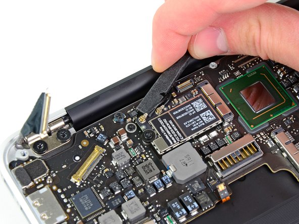

Image #1 Image #2

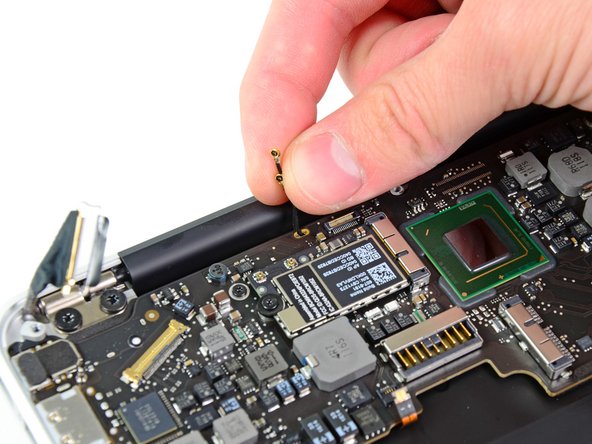

Add Note Edit Step 21  ¶
  • Use the flat end of a spudger to pry both antenna cable connectors up and off their sockets on the AirPort/Bluetooth card.
Image #1
Add Note Edit Step 22  ¶
  • Gently de-route the antenna cables from the slot cut into the logic board.

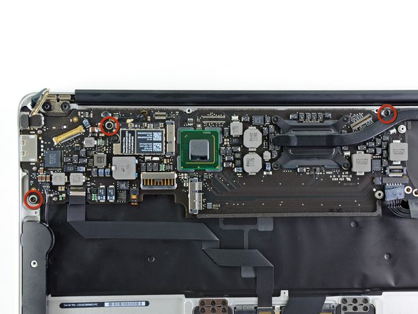

Add Note Edit Step 23  ¶
  • Remove the three 3.6 mm T5 Torx screws securing the logic board to the upper case.
Image #1
Add Note Edit Step 24  ¶
  • Gently lift the logic board assembly out of the upper case, minding the fragile heat sink and any cables that may get caught.
