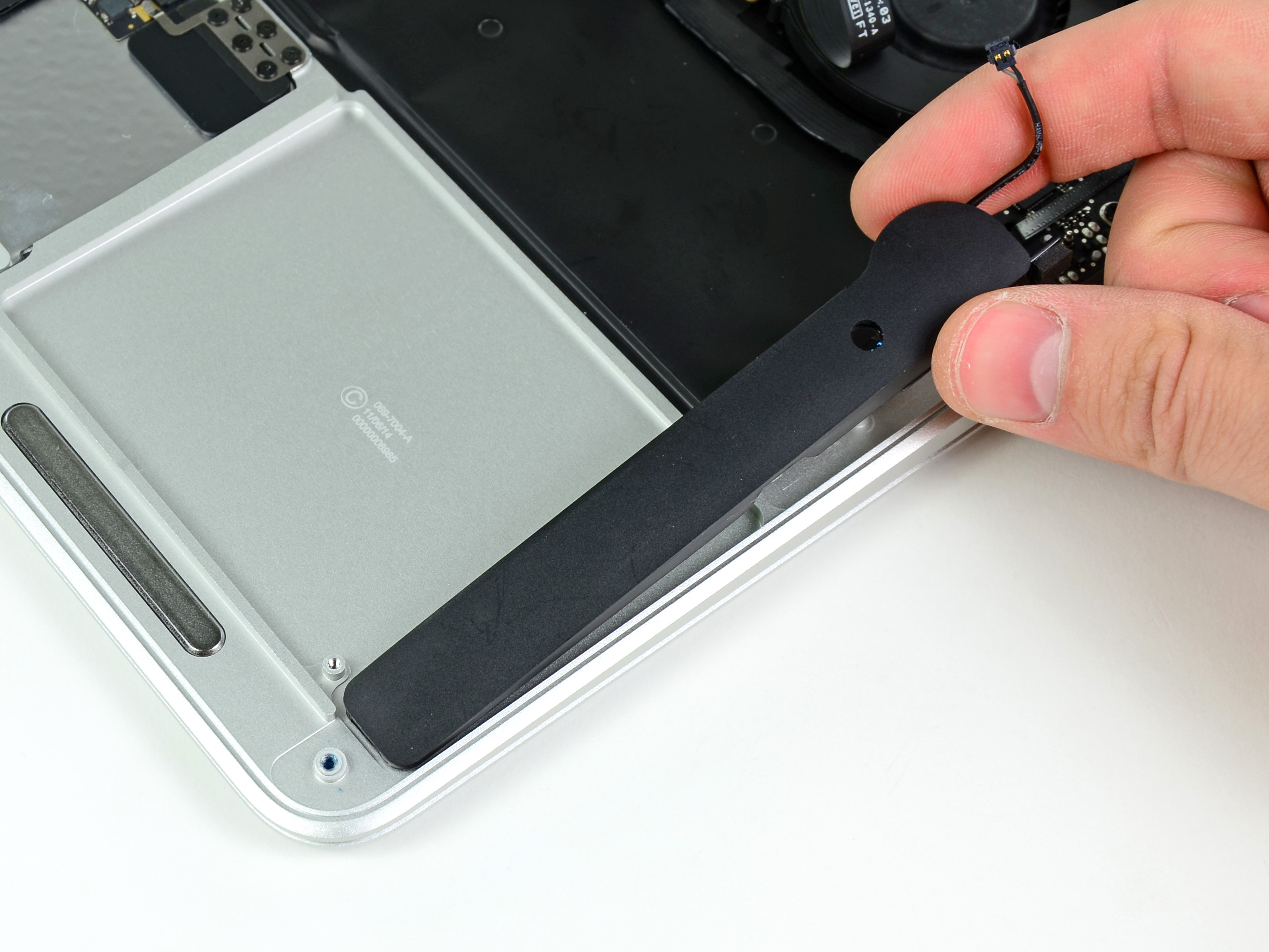

  9. MacBook Air 11" Mid 2011 Left Speaker Replacement: step 9, image 1 of 2 MacBook Air 11" Mid 2011 Left Speaker Replacement: step 9, image 2 of 2
    • Use the flat end of a spudger to pry the left speaker off the adhesive securing it to the upper case.
    • Only pry up on the speaker from the areas of bare aluminum on the upper case. Prying up from the keyboard area may damage the keyboard and the speaker itself.
  10. MacBook Air 11" Mid 2011 Left Speaker Replacement: step 10, image 1 of 1
    • Remove the left speaker from the upper case.
